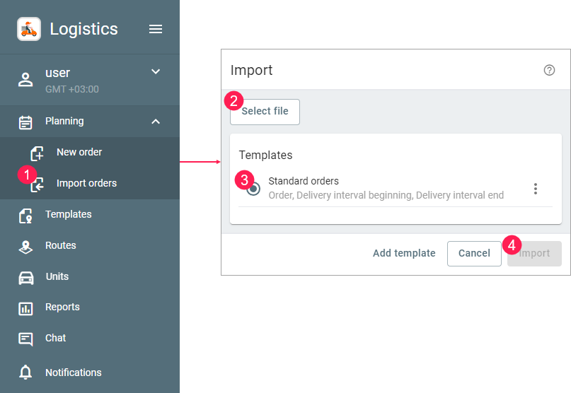

To import orders, follow the steps below.
  1. Select Import orders after expanding the Planning item in the navigation bar.
  2. Click Select file and select the file from which you want to import data. The maximum file size is 8.3 MB.
  3. If necessary, select the existing template or create a new one (the Add template button).
  4. Click Import.

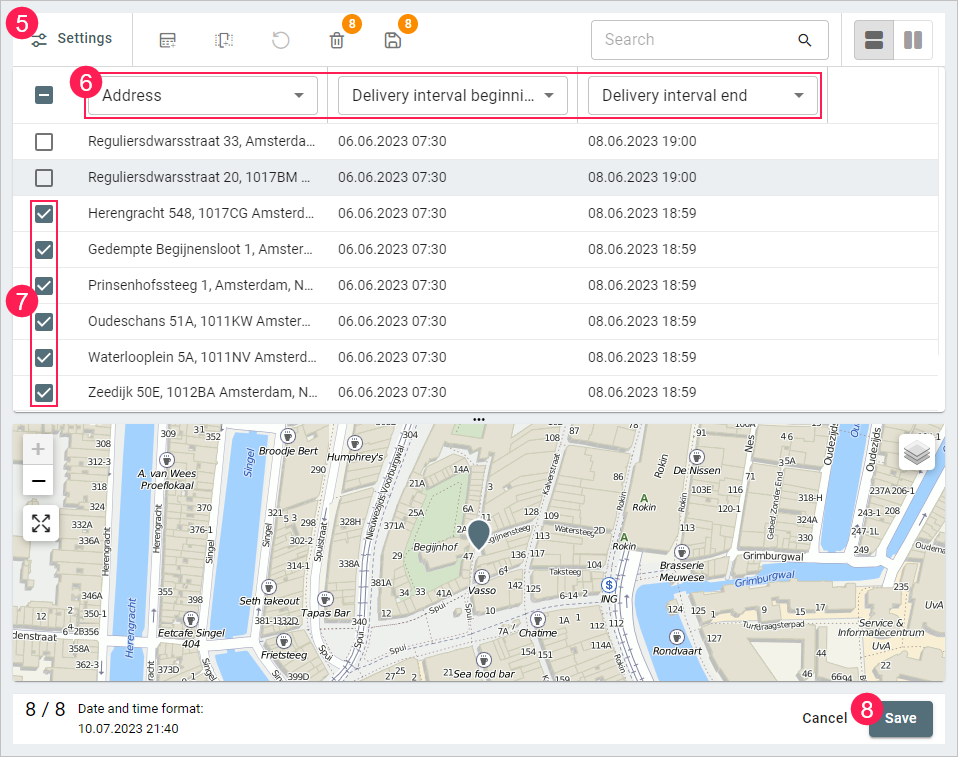

  5. Enable the Exclude first line option in the settings of the table of orders if the file has its own column headings.
  6. Select column headings in the drop-down lists. The Address (or Latitude and Longitude), Delivery interval beginning and Delivery interval end columns are required. The values in the table are then checked and the found order addresses are shown on the map. You can upload a table without coordinates and address if a geofence is specified in one of the columns. The geofences must be stored in the same resource in which the orders are created. You must select the Address name for a column with the geofence.
  7. Select the orders you want to import. To edit a cell, click on it, make changes, and save them. Enable the Repeated orders option in the settings if these orders should be fulfilled several times.
  8. Click Save.

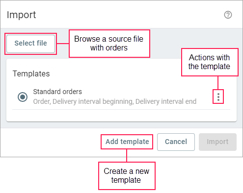

Import templates
Import templates are column headings saved in a certain sequence. They are required so as not to select column names in the import table manually. You can create templates in the window of selecting a file for import (the Add template button) or in the table at the next stage of import (the icon  in the lower-left corner). In the template creation window, specify the template name, edit the set of columns if necessary and save the changes.
The list of the created templates is shown in the window of selecting a file for import. Here you can also copy, edit and delete templates (the icon  opposite the template name)

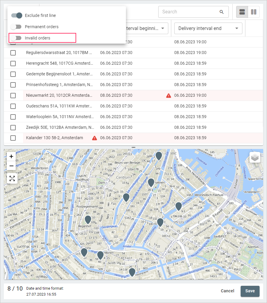

Checking order values
After selecting the required columns, such as Address, Delivery interval beginning and Delivery interval end, their contents are checked for validity. Fields with invalid values, for example, incorrect address or date format, are marked with the icon . To show only orders with invalid values in the table, enable the Invalid orders filter in the settings in the upper left part of the table.
After clicking Save, such orders are not added to the Planning page and remain in the table. You can edit and delete them, as well as export them to a file.
