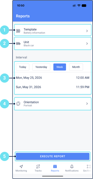

To execute a report, follow the steps described below.
  1. Select a report template.
  2. Select a unit/unit group or a geofence/geofence group (depending on the selected template, the list shows all the available objects).
    If a specific unit is bound to the report template and you have the Request reports and messages access right to it, the list shows only this unit. If you don’t have the required access right to it, the list shows the units to which you do have this right.
  3. Specify the time interval. You can set it using the quick interval buttons (Today, Yesterday, Week, Month) or manually. To specify the interval manually, tap the start and end lines, and select the required dates and time in the calendar.
  4. Select the page orientation of the report.
  5. Tap Execute report.
The report is opened as a PDF file. You can open it in another application, send by email or messenger, and so on (the icon  in the upper-right corner of the screen).
The selection of the template, object, and page orientation is saved until the next time you run the report.
