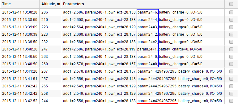

Switch to the Messages tab and request messages for any interval of time. Indicate Show parameters as raw data. In the column Parameters find the parameter you are interested in and analyze its incoming values.
You can see that when the temperature goes down and crosses 0 degrees threshold the necessary negative numbers are constituted with enormously large ones.

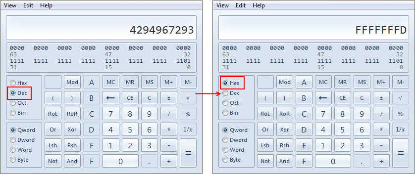

Firstly, you should define the maximum threshold for such numbers. In order to do so, take any of the incredibly large digits, which occurs in the values of the parameter, and enter it into a calculator in the decimal mode (Dec.). Afterwards, switch to the hexadecimal displaying (Hex. mode).
Count the register length in the number appeared. Possible values are: 2, 4, 8. If the register length is less, we should round it up (for example, 5 should be rounded up to 8). In our case the register length is 8.

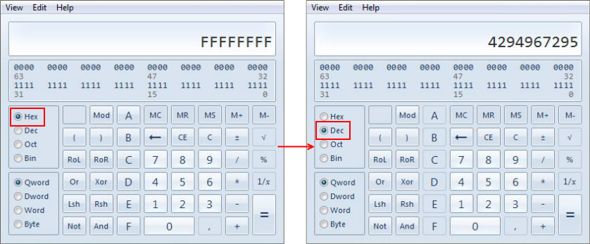

Now letter F should be entered in to the calculator in Hex. mode as many times as the register length appears to be after rounding up. Afterwards, switch to the Dec mode. Appeared result is the maximum possible number. You should write it down or memorize.
