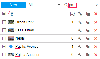

Dynamic search
If the list contains many items, it may be difficult to quickly find the required one. For convenience, you can use the dynamic search available in most panels. Start entering the name of the object (geofence, unit, route, and so on, depending on the active panel). You can type just a part of the name. As you enter the text, the list shows the items that match your query. The search is not case-sensitive.
If you leave the filter field empty, all the available items will be displayed in the list.
