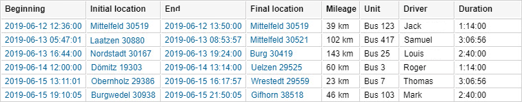

The Bindings table may include the time and location of the passengers boarding/leaving a vehicle, name of the unit used by passengers, duration of a trip, etc.
| Column | Description |
| Beginning | The time a passenger was bound to a unit. |
| Initial location | The location of the passenger when binding to a unit. |
| End | The time the passenger was unbound from a unit. If the unbinding happened automatically and the Show and mark as incomplete parameter is selected in the table as the action for an incomplete interval, Unknown is shown in the field. |
| Final location | The location of the passenger when unbinding from a unit. If the unbinding happened automatically and the Show and mark as incomplete parameter is selected in the table as the action for an incomplete interval, a dash is shown in the field. |
| Mileage | The distance the passenger travelled by the time they were unbound from a unit. |
| Unit | The name of the unit to which the passenger was bound. |
| Driver | The name of the driver of the unit to which a passenger was bound. |
| Duration | The time the passenger spent on the trip (time between binding and subsequent unbinding). In case of an automatic unbinding, 0:00:00 is indicated in this field. |
