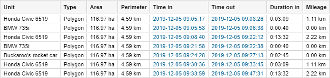

A template of the report on geofences and groups of geofences can contain a table of one type only: the Units table.
The Units table shows the information about what units visited the geofence or group of geofences, at what time they did it, how long they stayed there, at what speed they moved, etc.
When creating a template, you must select a unit or units which supposedly visited the geofence or group of geofences in the table settings.
The Units table can include the following columns.
| Column | Description |
| Unit | The name of the unit which visited the geofence. |
| Type | The type of the geofence (polygon, circle, or line). |
| Area | The area of the geofence. |
| Perimeter | The perimeter of the geofence. In the case of a line, its length is considered to be the perimeter, that is, its thickness is not taken into account. |
| Description | The description of the geofence (is taken from the geofence properties). |
| Time in | The time when the unit entered the geofence. |
| Time out | The time when the unit left the geofence. |
| Duration in | The time the unit stayed in the geofence. |
| Total time | The time from the beginning of the first visit to the end of the last one. |
| Parkings duration | The total parking time in the geofence. |
| Off-time | The time during which the unit was outside the geofence from the first exit to the last entrance to the geofence. |
| Mileage | The mileage inside the geofence. |
| Mileage (adjusted) | The mileage adjusted to the coefficient specified on the Advanced tab of the unit properties. |
| Off-mileage | The mileage outside the geofence from the first exit to the last entrance to the geofence. |
| Off-mileage (adjusted) | The off-mileage adjusted to the mileage coefficient. |
| Avg speed | The average speed of the unit inside the geofence. |
| Max speed | The maximum speed of the unit inside the geofence. |
| Driver | The name of the driver if they were assigned to the unit. |
| Visits | The number of visits to the geofence for the specified period. |
For the report on a group of geofences, activate the Detalization option in the table settings to see the detailed information about the visits of the unit or units to each geofence.
