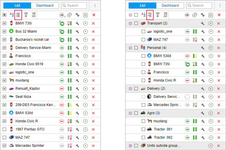

The work list has several display modes:
Each of these lists is independent, and their settings are stored separately. When you switch between them, all settings that were last applied to this type of list are restored.

Simple list mode

By default, the work list is sorted by names arranged in direct alphabetical order. The order can be reversed. To do this, use the switch button  or
 or  in the header.
 in the header.

Tree-like mode
In this mode, work list units are displayed in groups. Next to the name of the group in parenthesis you can find the number of units included in it. To view the units in the group or the current information on them, expand the group (+ in front of the group name). Any group unit can be removed from the work list (though it is not removed from the group itself).

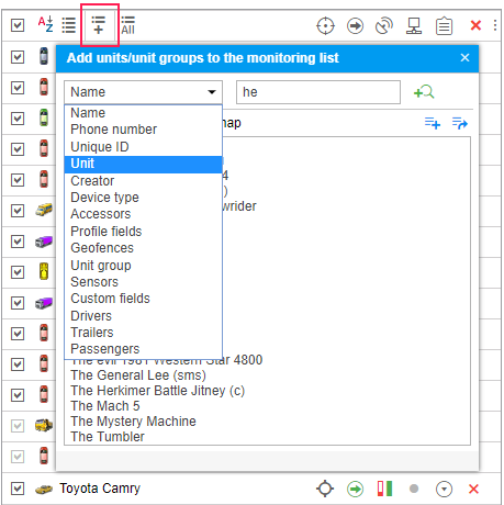

Searching and adding units
There is a convenient tool for finding units and adding them to the work list. To open the unit search dialog, click on the Add to the list button ( ) in the worklist header.
Unit search dialog displays all the available groups (in square brackets) and units in alphabetical order. To add units or unit groups, double-click on them. If the simple list mode has been activated, then single units (one or more) are added to the work list even if you double-click on a group.

Search by criteria
If you have a large number of units/groups, you can use special filters to quickly find the item. The dropdown list contains the following search criteria: name, creator, custom fields, profile fields, phone number, unique ID, device type, access from the user, geofences, sensor, drivers, trailers, passengers, etc.
Select a search parameter and then type a keyword into the next field. For instance, to find all MANs, select search by name, and in the template field type man. All units and groups which names contain the combination of characters man (both at the beginning and at the end of the name) will be found and displayed immediately. The comma sign (,) can be applied to string together several requests. For example, to find all MANs and all Ivecos, type *man*, *iveco*.
