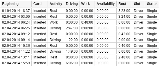

Driver activity
The Driver Activity table shows such information as the type of driver’s action, the crew of a vehicle, the state of the tachograph cards. It may include the following columns.
| Column | Description |
| Beginning | The date and time when activity begins. |
| Card | The state of the digital tachograph (inserted/not inserted). |
| Activity | The type of driver's activity (rest, work, driving, available, not available). |
| Source | The source of data, which is used to generate information about driver activity. The following column values are available: E — the data about trips is used; T — the tachograph data is used; U — the data about driver unbinding is used; None — the data source is unknown. |
| Unit | The name of the unit to which the driver is bound. |
| Driving | The time of driving. |
| Work | The hours of active work (time spent by the driver on vehicle repair, fuel filling, etc.). |
| Availability | The hours of passive work (time spent by the second driver in the moving vehicle). |
| Rest | The time for rest of the driver (vehicle is stopped, the driver rests in a specially designated place). |
| Overall work | The total time spent by the driver on such actions as driving, work, reserve. |
| Slot | The slot for digital tachograph card (Driver or Co-driver). |
| Status | The vehicle crew size (single/crew). |
| Daily mileage | The distance covered by the bound driver during the day (24 hours). |
While creating this report template, you should select in the parameters of the table the way to determine driver activity: DDD files (are sent by the tachograph), online data (generated online on the basis of the events of bindings and trips) or bindings and trips (messages are used as the source). If the Bindings and trips option is selected, the result of the report changes when you change the settings of the trip detector, delete messages, bind and unbind, etc.

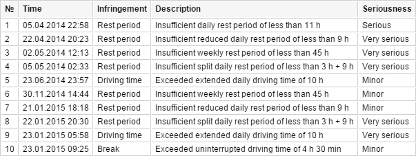

Infringements
This report shows information on the violation of labor routine by the driver. It may include the following columns.
| Time | Date and time of violation recording. |
| Infringement | Type of driver's activity the conditions of which have been violated. |
| Description | A short description of the infringement. |
| Seriousness | The extent of the infringement. |
| Quantity | The number of violations. If the grouping option is activated, this column shows the total number of violations for the selected interval. |
While creating this report template you should choose in the parameters of the table a driver activity source: DDD files (are sent by the tachograph), online data (are formed online on the basis of the events of bindings and trips) or bindings and trips (messages are used as the source). If the Bindings and trips option is selected, the report’s result changes in case of changes in the trip detector’s settings, deleting messages, bindings, and unbindings, etc.

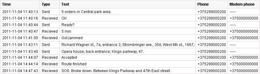

SMS messages
This report shows the correspondence of the dispatcher with the driver via SMS. The dispatcher (operator) can send messages to the driver from the Wialon interface through a special SMS window. The driver sends messages from his mobile phone. This mobile phone number must be indicated in the driver’s properties.
The following columns can be included in the table.
| Time | The date and time when the message arrived. |
| Type | The message type: sent (message sent by the dispatcher) or received (message received from the driver). |
| Text | The text of the message. |
| Phone | The phone number of the driver. |
| Modem phone | The phone number of the modem that sent/received an SMS. |

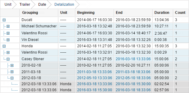

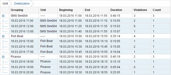

Additional possibilities
For the Binding and SMS messages tables, you can apply grouping by days/weeks/months, but you need to take into account that in these tables only one level of nesting is possible, i.e. at the first level - units, on the second — generalized information for the specified date/week/month (the second level is not disclosed).
