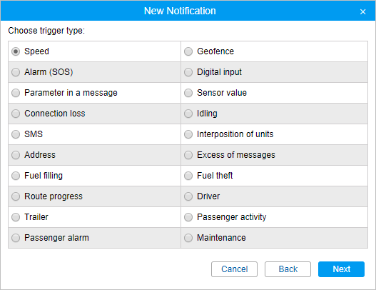

Notification Types
There are different conditions for triggering notifications.
Speed
