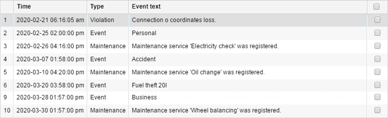

In the table you see:
  • the time when the event was detected (automatic registration) or registered (manual registration);
  • type: event (traffic counter reset, events from notifications, some custom events, route control statuses), violation (violations from notifications, some custom events), maintenance (registered manually);
  • event text which is taken from the text of notification or from the description entered while registering manually.
