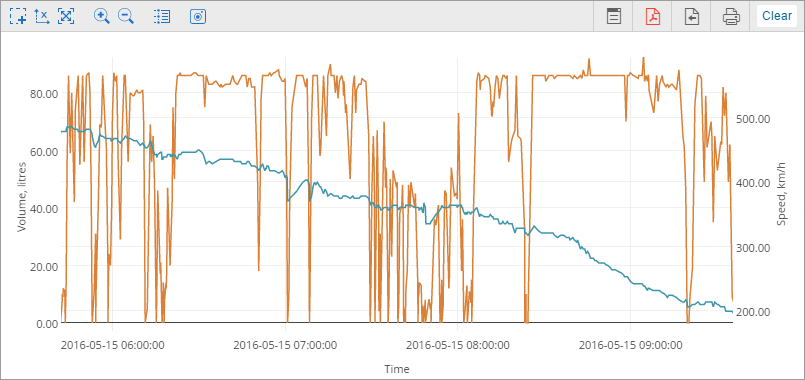

You can simultaneously select two points. In this case, the chart will contain two curves, for example, speed and engine revs. You can select even more points but note that only two variables can exist in one chart in addition to time. It means if Y-axis represents speed scale on the left and temperature scale on the right, nothing can be added to this graph. But if Y-axis represents speed scale on the left and consumption by ImpFCS on the right, it is still possible to add consumption by AbsFLS and other methods, since they are all measured in the same metrics.
The picture below shows the speed chart combined with the fuel level chart. To receive such a chart, it is required to set the chart type as Regular and select the Speed and Fuel level data.
Each curve on a chart is assigned its own color. On the left, in the Report result block, you can specify which color corresponds which curve. Their names are taken from the report template. In addition to the name for the curves, the units of measurement are also indicated.
The names of the lines of the chart can be changed in its properties in the report template. However, if the curve is built based on some sensor, then it is given the name of the sensor.
Click on the curve name in the Report result section to enable/disable its display on the chart.

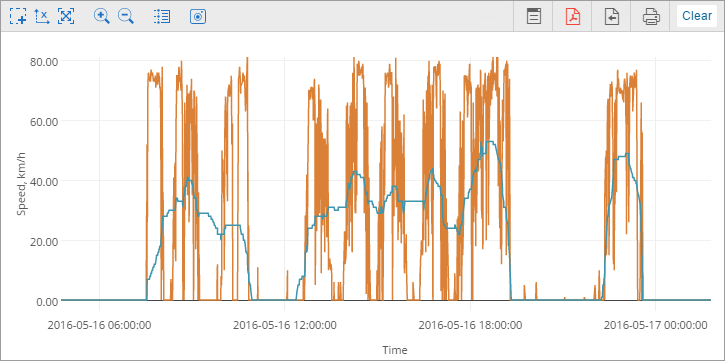

Almost all charts of the Regular type are provided in two forms: raw and smoothed (smoothed is indicated in parentheses after the name). Smoothing affects the style of the chart display. The chart without smoothing is built straight from a message to message, and, as a result, has an angular outline. If you choose smoothing, the chart has a smoother outline. The level and algorithm of smoothing for all charts are the same.
Below is an example of a chart in which a raw speed chart is displayed with an orange line, and a blue one shows a smoothed chart.

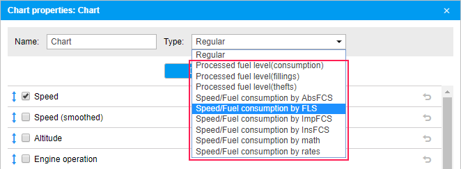

Special charts
Along with the regular charts, the following charts are available:
  • Processed fuel level
  • Speed/Fuel Consumption by…
Settings for these charts are fixed and cannot be changed. Editing is available only for the name of the chart. Also, it is possible to select the required sensors (indicate the mask of the sensor).

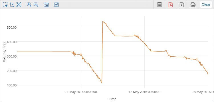

The Processed fuel level chart shows the values which are used while calculating fuel level, fillings and thefts in tables.
The chart shows the dependence of fuel level on mileage (mileage/liters). It can also show the dependence of the fuel level on time (time/liters) if the Time-based calculation of fuel consumption option is turned on in the unit settings.
In both cases the chart is processed taking the filtration into account, which is set on the Fuel Consumption tab (the Filter fuel level sensors values option) or in the sensor properties.

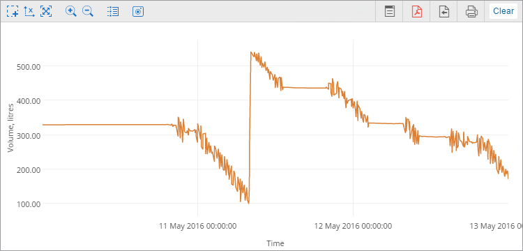

Below are two fuel level charts: the first one is processed (time-based FLS and filtration are on, the filtration level is 25), and the second one is not processed.

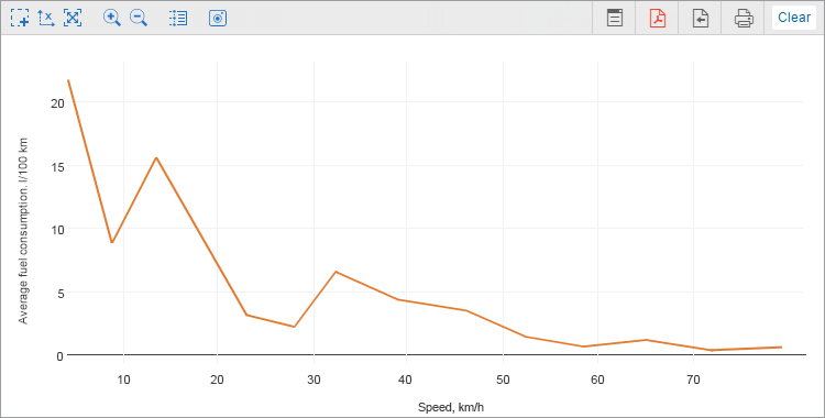

Speed/Fuel consumption chart
This chart shows the dependence of average fuel consumption on speed. The data for it is taken from fuel consumption sensors of different types (such as impulse, absolute, instant) or fuel level sensor, or predefined consumption by math or rates. The corresponding calculation methods must be specified in the properties of the unit in the Fuel consumption tab.
