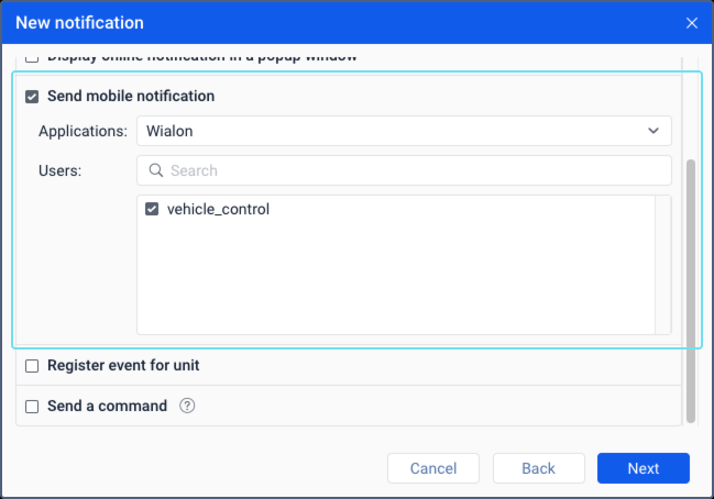

Send mobile notification
This action allows you to configure sending mobile notifications. The action is available if the Mobile notifications service is enabled in the properties of the user’s account.
To work with this action, you should have full access to the unit, to the recipient users and to the user-creator of the resource in which the notification is stored. The user-creator of the resource in which the notification is stored should have full access to the recipient users.
To configure sending mobile notifications, follow these steps:

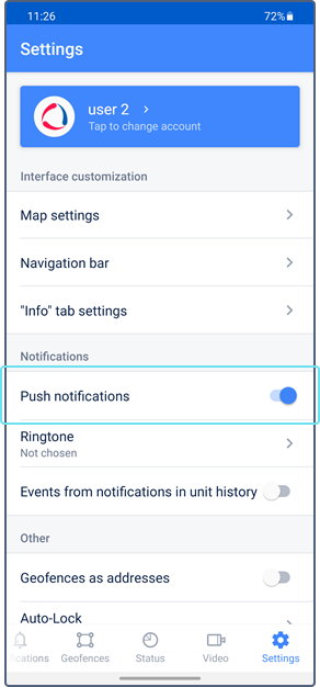

  1. Make sure that the users who should receive notifications are authorized in the mobile application and have the option allowing them to receive notifications enabled. In the case of  Wialon mobile application, the Push notifications option should be enabled in the settings.
  2. Select the mobile application to which the notification should be sent.
  3. Select the users who should receive the notification. To find them, use the dynamic filter above the list. To select all the users at once, select one of them while holding down the Ctrl key.

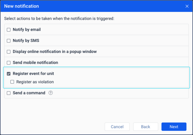

This action allows you to register events in the unit history. To do this, the creator of the resource where the notification will be stored must have full access to the unit.
The registered events are displayed in the Events report table. In order for events to be registered as violations, enable the Register as violation option.
