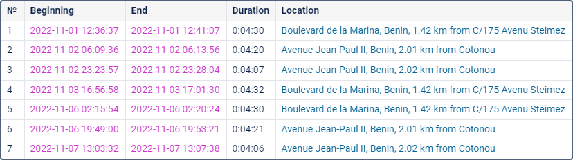

Column Description
Beginning The time when the parking started.
End The time when the parking ended.
Duration The time interval of a parking.
Total time The time from the beginning of the first parking to the end of the last parking.
Off-time The time interval from the end of the previous parking to the beginning of the current parking (defined starting from the second parking).
Location The address where the unit was stationary. If there was an insignificant movement detected, the initial unit location is indicated. If the unit location is not available during the parking interval, then it is determined by the initial unit location on the trip that follows the parking.
Count The number of parkings (useful when grouping rows by years/months/weeks/days/shifts or for the reports on unit groups).
Notes An empty column for your custom comments.

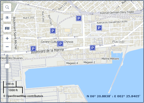

The parkings can be displayed on the map. To make use of this feature, select Parking markers in the report template.
