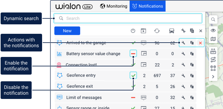

On the Notifications tab, you can see a list of all the available notifications. Above the list, there is the New button for creating notifications and a Search bar for dynamically finding notifications by different criteria. For details, see the Searching notifications page.

Condition icon The icon representing the specific condition (for example, geofence, sensor value, connection loss, and so on). If a notification has multiple conditions, the icon is . See Configuring conditions for a detailed description of conditions.
Name The name given to the notification.
Indicates if the notification is enabled or disabled . Clicking it toggles the state. Use the icon in the header to change the state of all notifications at once.
Shows the action performed by the notification (for example, popup window, email, SMS). If several actions are configured, their number is shown. Hover over the number to view the list of actions. See Configuring actions for a detailed description of actions.
The number of times the notification has been triggered.
The number of units for which the notification is configured. Hover over the number to view unit names and icons.

You can perform the following actions for each notification using the icons in the list:
Icon Action
Disable the notification (the icon changes to as a result).
Enable the notification (the icon changes to as a result).
/ Edit the notification parameters, or view them if you don’t have the Create, edit and delete notifications access right.
Copy the notification, that is, create a new notification using the current one as a template.
Delete the notification.
