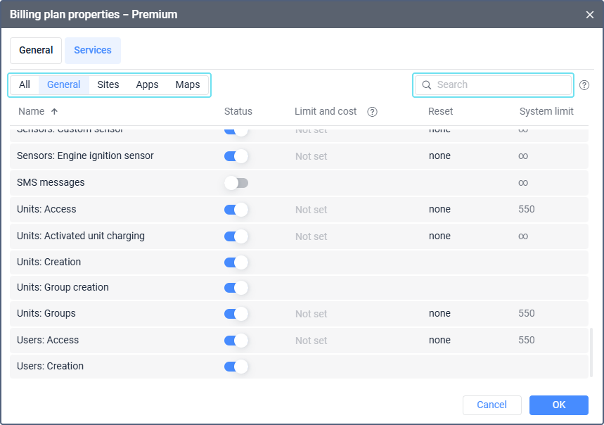

Services
This tab displays all the services available for the selected billing plan.
To find the service by its name, start typing in the dynamic search field.
The “Services” tab filters
The services can be arranged into groups using the following filters: All, General, Sites, Apps, Maps.

Service settings
Depending on the selected filter, the list of services can consist of the following columns:
| Column | Description |
| Name | The name of the service. See the full list of services and their description here. |
| Status | The state of the service. Click on the button to disable or enable the service. By default, the deactivation of a service in a billing plan leads to its automatic deactivation in the account to which this plan is assigned. However, if the state of the service is additionally changed in the properties of a separate account, then it is given priority. An account user does not have access to services that are disabled in a parent account. |
| Limit and cost | In this column, you can specify the values of the service quantity and cost. For example, if you specify number 100 for the Units: Access service, this means that no more than 100 units can be created in the accounts to which this billing plan is assigned. You can indicate the limit and cost for the billing plan in the same way as for the account.You can also specify the service limit and cost individually for each account on the Services tab of its properties. These values can be greater than the values from the billing plan properties, but not greater than the values from the Limit column. |
| Reset | Here you can select how often the specified service limit should be reset: hourly, daily, weekly, or every calendar month (monthly). For example, if you specify 10 SMS messages per day, then the users of the accounts to which the billing plan is assigned cannot send more than 10 messages a day. |
| Limit | This column shows the limit on the service quantity applied to the top account. The limit is set automatically based on the total number of units in all the accounts of the service. |
You can sort the services by their name and status by clicking on the column heading.
