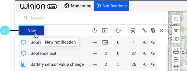

  1. Click New on the Notifications tab.

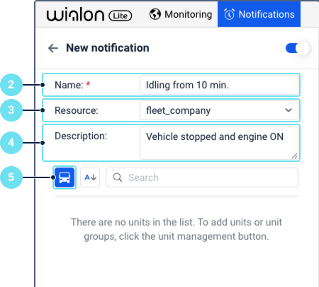

  2. Enter a descriptive name for the notification.
  3. Select the resource in which the notification should be stored if you have more than one resource available.
  4. Optionally, add a description for the notification to provide more details about its purpose or settings.

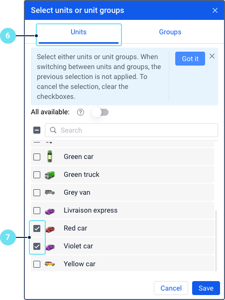

  5. Click the icon to open the Select units or unit groups window.
  6. In this window, switch between the Units and Groups tabs to find your required items. Use the All available toggle: enable it to make all units and unit groups available for selection, or disable it to show only those currently added to your monitoring list.
    You can select either units or unit groups, but not both simultaneously. When switching between the Units and Groups tabs, any selection made on the previous tab is canceled. Only the selection on the currently active tab will be saved.
  7. Check the boxes next to the required units or groups and click Save.

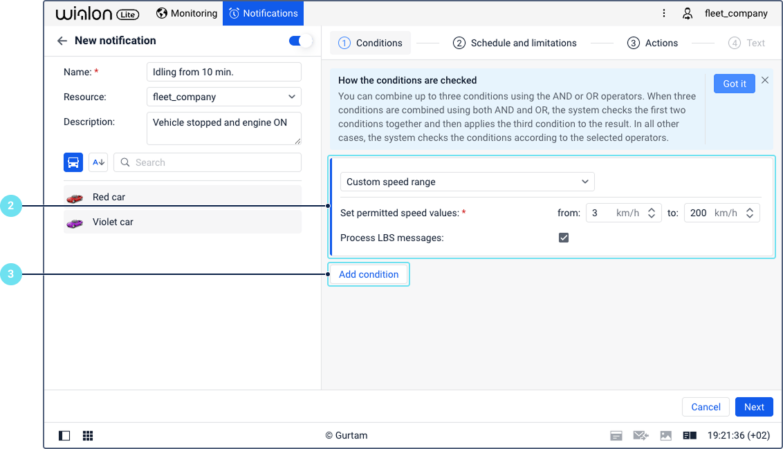

  1. Select a condition when a notification should be triggered. See Configuring notification conditions for the full list, their settings and additional access right requirements.
  2. Configure specific settings for this condition type. Some of them are required and some are additional. If a required setting is missing, the icon is displayed next to the step title.
  3. If you need to add a second condition, click Add condition. You can add up to three conditions to a notification.

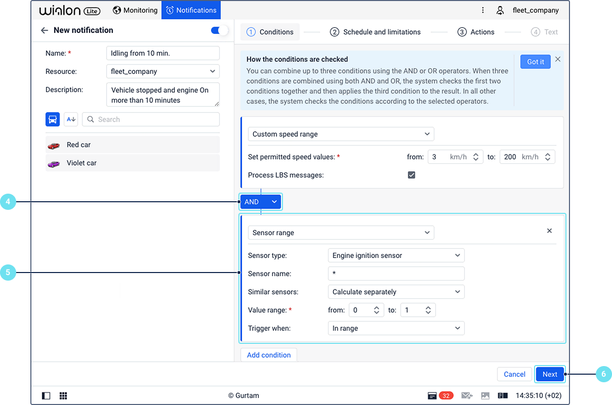

  4. Select AND or OR operator. If the AND operator is selected, both conditions must be met for notification triggering. If the OR operator is selected, any of the two conditions must be met for notification triggering.
  5. If you have added a second condition, configure it as well. If you have added a third condition, select the operator for it and configure it too.
  6. Click Next.

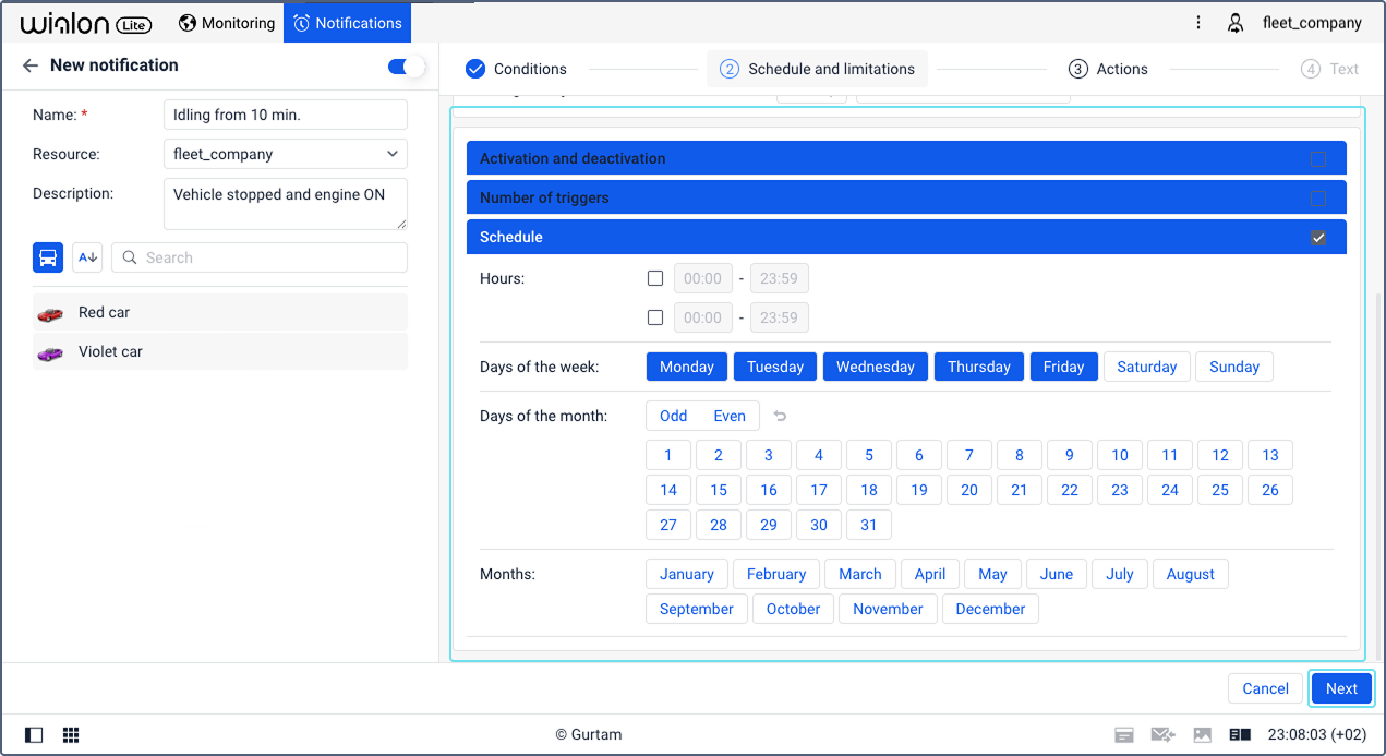

Step 2. Set limitations or schedule (Optional)
You can restrict when and how many times the notification is triggered. See Setting notification limitations and schedule for a detailed description.
Go to the next step by clicking Next.

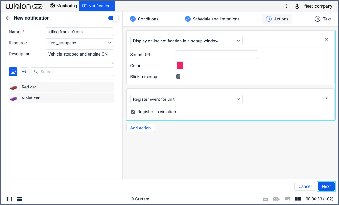

Step 3. Configure actions
Select and configure one or several actions that should be performed automatically when the notification is triggered. Some actions require additional access rights. See Configuring notification actions for a full list of actions, their settings and required access rights.

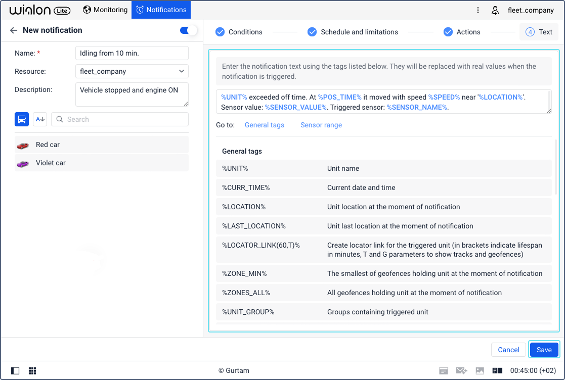

Step 4. Add notification text (if applicable)
Enter the message text to include in delivered notifications, if the selected action supports custom text. You can add tags (variables) that will be replaced with real values ​​when the notification is triggered. Available tags depend on the notification conditions. See Configuring notification text for details.
Save the notification.
