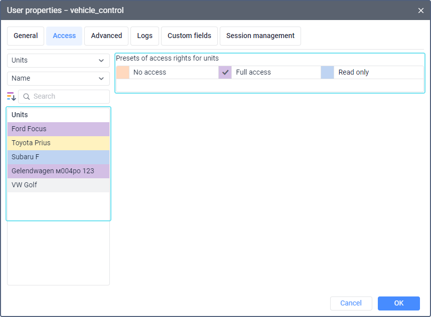

Presets of access rights
There are 3 standard access rights presets available for users:
  • No access
  • Full access
  • Read only
Objects in the list on the left are highlighted in the color that is assigned to the preset. The objects with Full access become purple and the objects with Read Only access become blue. If a user restricts access rights to an objects using the No access preset, its row in the list is highlighted in yellow color. If the rights to the object have been fully restricted before, the line remains transparent.
A user with No access cannot see or edit the object. Full access allows the user to see the object and edit it.
The Read only preset does not give the user the right to edit the object properties. The information listed in the table below is available for viewing.
