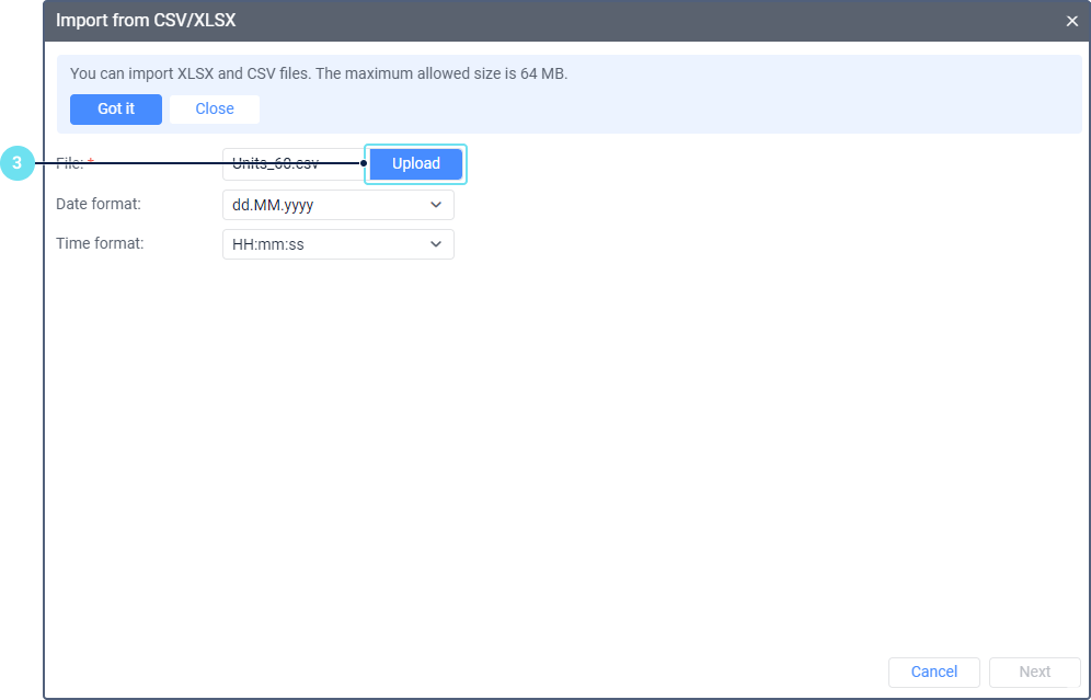

To upload the file from which you want to import data, follow the steps below:
  1. In the user menu, select Import/Export and then select Import from CSV/XLSX.
  2. Click on the Browse button and select the file you want to upload.
  3. Click Upload.
  4. Select the date and time format used in the file. If there are no such fields in the file, skip this step.
  5. For a CSV file, specify the separator: comma, semicolon, colon, or tab.
  6. Click Next.

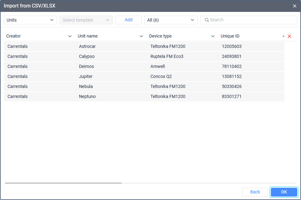

Preparing the table for import
To prepare the uploaded data for import, follow the instructions below.
  1. Select Units as the type of items you want to import. The import of drivers and fuel fillings is not available.

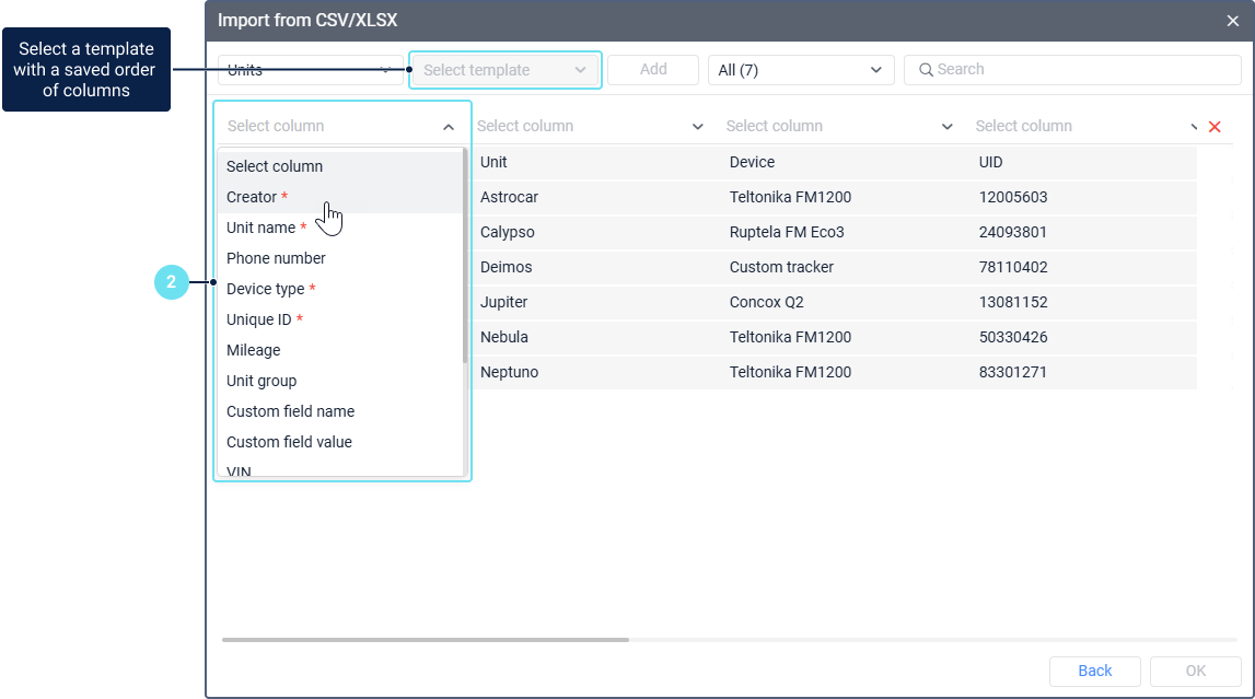

  2. Specify the headings of the columns. To do this, you can apply a previously saved template or select headings from the drop-down lists above the columns. Mandatory headings are marked with an asterisk (*). For a description of all available columns, see the Unit import table section.
If no name is selected for a column, its contents are not imported into the system.

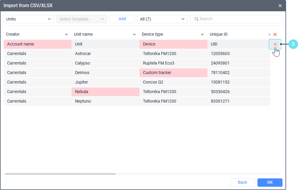

  1. If necessary, delete the first line and other unnecessary lines. To do this, point to the line and click on the icon at the end of the line.
  2. Make sure the table shows valid data. To do this, select Invalid in the filter. If nothing is found by the filter, all rows are valid. If invalid data is found, edit it.
  3. If necessary, save the template so that you can immediately apply the same column order the next time you import data.

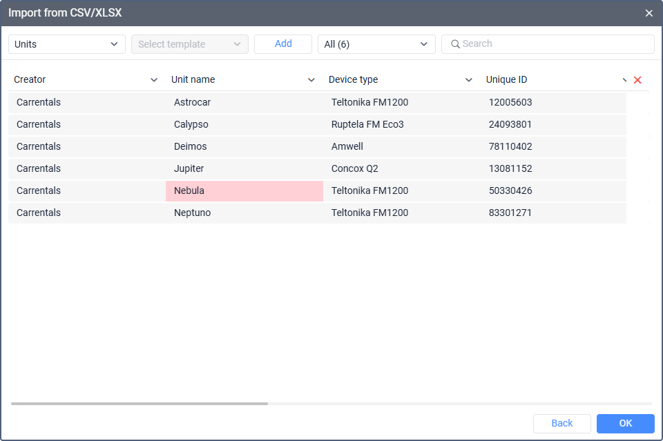

If a number other than zero is shown in brackets to the right of the Invalid option, select this option and edit the found rows. Otherwise, they will not be imported.
Editing data

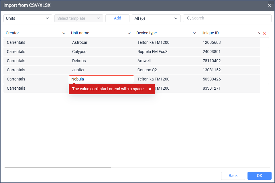

Cells with invalid data are highlighted in red color in the table. It is impossible to import items with such cells.
You can correct invalid data as follows:
  1. Click on a red cell.
  2. Read the tooltip to find out why the error occurred.
  3. Enter the correct data.
  4. Click outside the cell to save the changes.
When editing data in most columns, you must take into account special requirements. They are described in the Unit import table section.

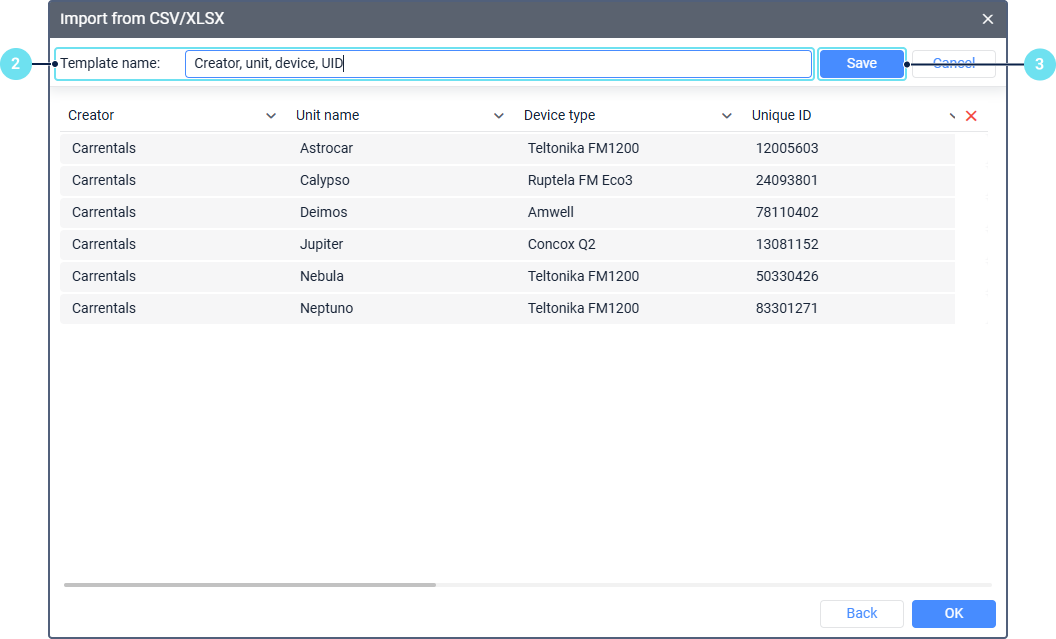

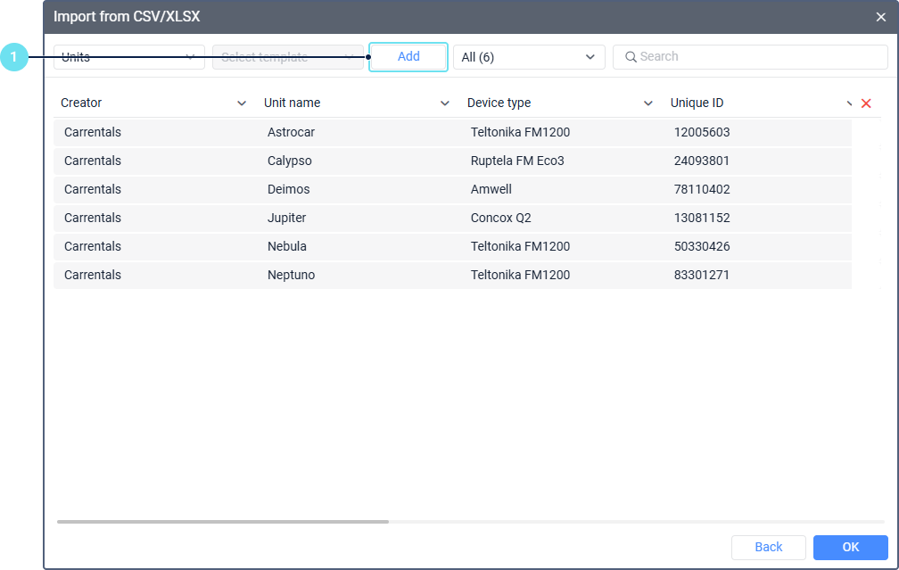

Once you have selected the column headings, you can add a template, that is, save the order of the table columns. This is not a mandatory step, but it will save you time during your next import. Instead of selecting column headings manually, you will be able to select the template and the saved column order will be automatically applied to the table.
To add the template, follow the steps below.
  1. Click Add.
  2. Specify the template name (max. 50 characters).
  3. Click Save.
The added template is shown in the list of templates.

Completing the import and checking the results
To complete the import, click ОК.
