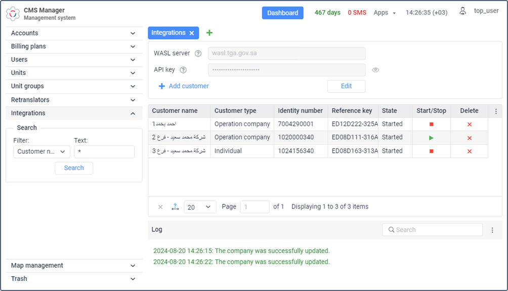

Specifying the Wasl server and API key
On the Integrations tab, fill in the Wasl server and API key fields and click Save.
| Field | Description |
| Wasl server | The address of the Wasl server to which data from Wialon Lite should be transmitted. By default, wasl.tga.gov.sa is indicated. |
| API key | The API key obtained after registering on the Wasl platform. |
The specified server and key are used for all the customers you register. If you want to edit these fields, click Edit, enter new data, and save it.
Now you can proceed to register customers, drivers, and vehicles.
