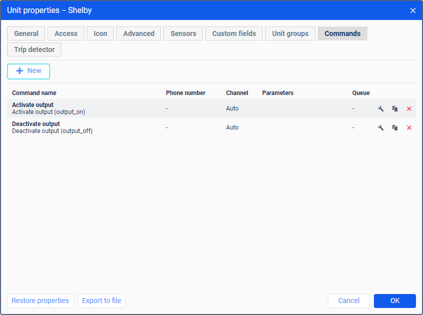

Creating commands
To create a command, click New (plus icon), specify its properties, and click OK.

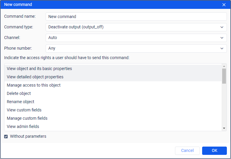

Command properties
Commands have the properties described below.
Property Description
Command name The name of the command. Command names should not be repeated in the properties of one and the same unit.
Command type The initial name of the command in the system. The list shows only those commands which are supported by the unit device. See the list of commands supported in the system.
Channel The channel (connection type) via which the command should be sent: Auto, TCP, UDP, Virtual, SMS. The list of channels depends on the device type selected on the General tab. Read more about the channels below.
Phone number The phone number is required for commands sent via SMS. Some types of equipment can support two SIM cards. In this case, you can select which of the two phone numbers should be used to send the command: First, Second or Any. If you select Any, the message is sent to the first phone number, if specified. If the first number is not specified, the message is automatically sent to the second. You cannot change the number at the time of sending the command.
Access rights Not applicable in the system.
Parameters Some commands require additional parameters. These could be, for example, the input or output number, and so on.
To specify the parameters, clear the selection of the Without parameters option and fill in the required fields. If the parameters are not specified when creating the command, you should specify them when sending it. The parameters specified when creating the command cannot be changed at the time of sending it.
