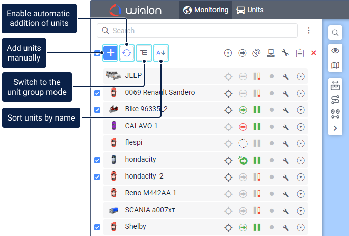

Adding units to the work list
You can add units to the work list manually or enable automatic addition of units. To do this, use the following buttons:
Button Description
Opens a menu for adding units manually. The menu consists of two items:
  • add units or groups;
  • add all available.
To add a certain unit or units to the work list, select the first item and follow the guide below.
To add all the units available to you at the moment, select the second item and confirm your action.
This button is unavailable if the automatic addition of units is enabled (see below).
Activates the automatic addition of available units to the work list. If the button is enabled, as soon as new units become available to you, they are immediately shown in the work list.
When the automatic addition feature is enabled, the Data recency filtering is unavailable.
To use this feature, click on the button and confirm your action. To disable it, click on the button again.

Sorting
By default, the work list is sorted by names arranged in direct alphabetical order. The order can be reversed. To do this, use the switch button or in the header.
Besides, it is possible to sort units by other attributes such as motion state, connection quality, etc. To do this, use the buttons in the header:

For instance, to sort units by the motion state, use the button . The list is rearranged in such a way that all the moving units appear at the top of the list, and those that are not moving appear at the bottom. To reverse the motion state order of units, click on the button again.

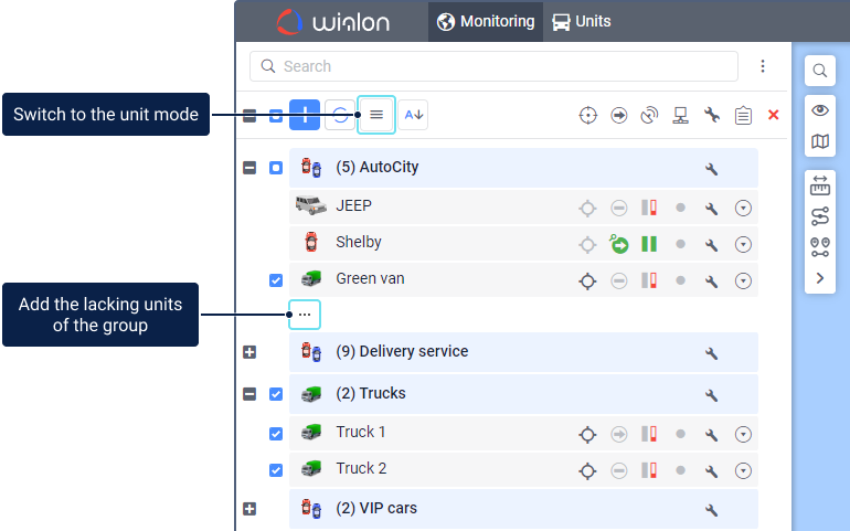

Unit group list
To switch to the unit group list mode, click on the icon .
In this mode, the units from the work list are shown by groups. Next to the group name, you can see the number of units in it. The group tooltip displays the list of the units that belong to this group.

Opens a menu for adding groups and units manually. Works in the same was as in the unit list.
If there are no units in the group, it is not added to the work list using this icon.
Activates the automatic addition of available units to the work list. Works in the same was as in the unit list.
horizontal three points icon Add the remaining units of the group to the list. This icon is shown at the end of the expanded group list only if some units belonging to the group are not shown in the list. You can see the number of the lacking units in the tooltip of this icon.

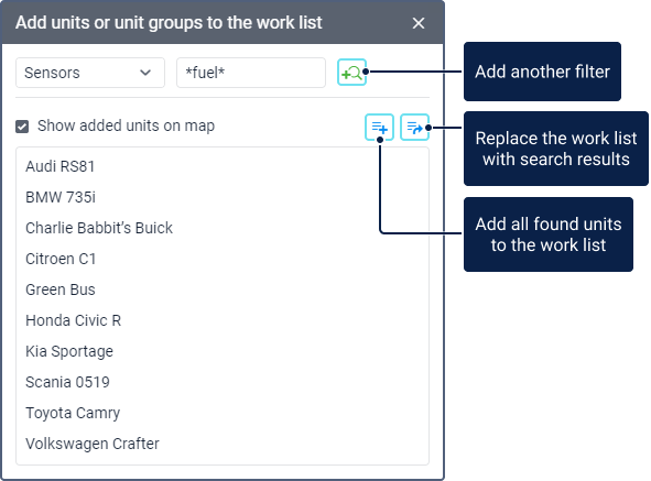

Adding units
If you want the added object to be shown on the map immediately, enable the Show added units on map option.
You can add a unit or a group with its units to the work list in one of the following ways:
  • double-click on the object in the work list;
  • add all the found (filtered) objects using the icon ;
  • replace the existing work list with all the found (filtered) objects using the icon .
If the added unit belongs to a certain group, then this group is also added to the list but without the rest of its units. If the unit doesn’t belong to any group, then it is automatically added to the Units outside groups group with the icon .

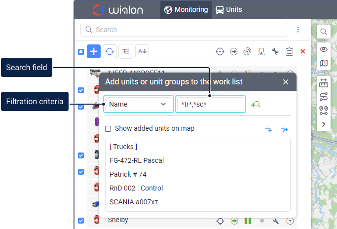

Searching by criteria
If you have a lot of units and groups, you can use filters to search for the required object. Below you can find information about filtering in the window for adding objects.
The following filtering criteria are available:
Filter Description
Name Search by the unit or group name.
Creator Search by the user on whose behalf the unit was created. Specified on the General tab of the unit properties.
Unique ID Search by the unique unit ID specified on the General tab of the unit properties.
Phone number Search by the phone number specified on the General tab of the unit properties.
Device type Search by the device type installed on the unit. Specified on the General tab of the unit properties.
Unit group Search for units by their belonging to a certain group. After selecting the filter, the list shows only those units that belong to a certain group. If you specify the group name in the search field, the list shows only those units that belong to this group.
Unit Search for unit groups by the unit name. After selecting the filter, the list shows only those groups that contain certain units. If you specify the unit name in the search field, the list shows only those groups to which this unit belongs.
Custom fields Search by name or value of custom fields added on the same-name tab of the unit properties.
Accessors Search by the name of the user who has access to the units. After selecting the filter, specify the user name or the name mask in the search field so that the list shows all the units to which this user has access.
Geofences Search by the name of the geofence in which the unit is currently located.
Sensors Search by the name, type, or parameter of the sensor created in the unit properties.
The filters can work on several levels:
  • at the first level, you select a filtering criterion and the list shows only those units which have the selected property. For example, if you select the Sensors filter, the list shows only those units for which they are created;
  • at the second level, in the search field next to the filter, you specify one or several keywords (their masks) separated by commas. For example, to find all units with ignition sensors and/or fuel sensors, you can select the Sensors filter and specify *ign*,*fuel*;
  • at the third level, you can add one more filtering criterion by clicking on the icon and search among previously filtered units, etc.
