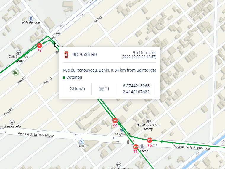

Hover the cursor over a track to get accurate information about a specific point of the track (points where messages were received). Messages are searched in the radius of 50 pixels from the cursor. Points found are highlighted by a pulsating circle, and a tooltip appears with the following information: time, address, speed, altitude, coordinates, satellites, and sensor values. Messages with zero speed are marked with bigger points. Measurements used in the tooltip are borrowed from the unit properties (speed in kilometers or miles per hour, altitude in meters or feet), as well as mileage in the list of tracks. The information from the tooltip can be copied to the clipboard.

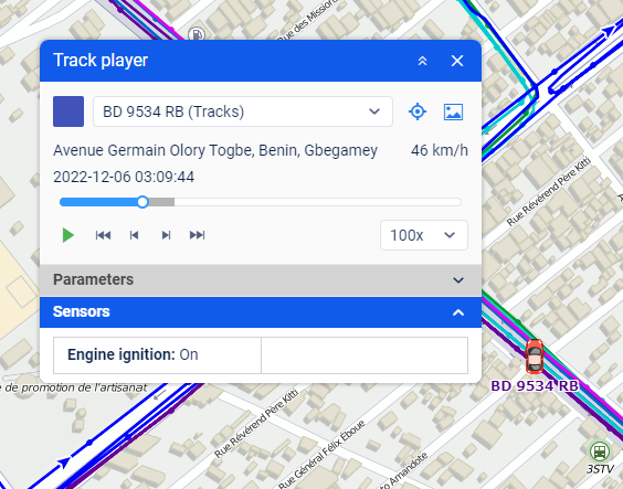

Track player
To play the track, click on the button
. It opens Track player and launches the playback. The unit icon moves along the track line at the selected speed.
Player settings
The map can be moved manually or automatically. This setting is adjusted with the icon
. If this option is disabled, you can only move the map manually. If it is active, the map moves automatically in the following cases:
- along with the unit during playback;
- when using the buttons of initial and final positions;
- when using the buttons for point-by-point movement on the track;
- when navigating the track by clicking on different places of the timeline;
- when choosing a new track in the drop-down list (the map moves to the first point of the track).
If messages from the unit contain pictures, you can show or hide them during playback using the icon
Select an appropriate playback speed from the drop-down list. It can vary from real-time speed (1x) to accelerated 1000 times (1000x, that is about 16 minutes of messages played in one second). Regardless of the selected value, messages with zero speed and no movement are played as fast as possible. If you change the playback speed while playing the track, a new value will be applied after you press Pause and then Play again.
Playback speed is rather conditional. Playback performance depends on the type of browser in use, computer processing power, number of messages in the track, and time intervals between the messages. In any case, all messages are played even if it takes more time.
