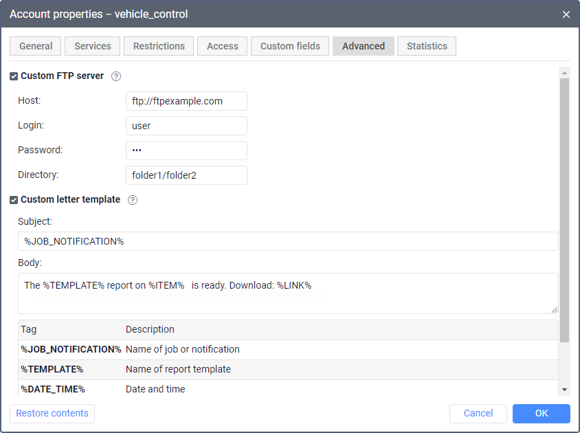

Advanced properties
To work with the Advanced tab, you should have full access to the account.
On this tab, you can specify the settings of the custom FTP server for receiving files and archives and configure the template of the message which should be sent by email.
Custom FTP server
When sending a report by email as a result of a job, you can select whether you want to receive files and archives themselves or just a link to the FTP server where they are stored.
By default, the Wialon Lite FTP server is used. To specify a custom one, activate the Custom FTP server option and indicate the host, login, password and the directory where files and archives should be stored.
Custom letter template
To specify the subject and text of the message sent by email as a result of a job or notification, activate the Custom letter template option and fill in the Subject and Body fields. The message body can contain tags which are converted to real values at the time of sending. Click on a tag to add it to the text.
