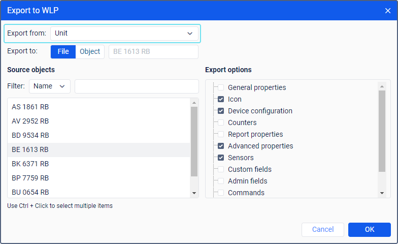

To export unit properties, select the Export to WLP item in the user menu and select Unit in the Export from drop-down list. See a detailed guide here.
To add the properties of one unit to another using a WLP file, select the Import from WLP item in the user menu and follow the guide.
