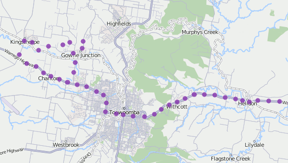

Track color
There are three mutually exclusive color settings for the track: By trips, By speed, and Single. One of these settings, except the first one, can be initially set on the Advanced tab of the unit settings. If the setting is not specified, the By trips option is selected by default in the track panel.
For a Single track, you can choose a color in the palette every time you build a track, or, if the color is not specified, for each new track the color will be selected automatically from the color range (it is selected circle-wise). The color is selected in the same manner if the Single setting is applied to the unit, and another color is chosen manually from the palette.

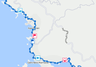

Markers
To highlight important events on the track, you can enable the display of markers.
You can use markers only if you have access to reports.
Below is the list of available markers:
  •  speedings;
  •  events (violations are identified by the marker );
  •  not applicable in the system;
  •  parking places;
  •  stops;
  •  initial and final positions (final positions are identified by the marker ).
You should enable markers before mapping a track. To do this, click on the icon of the required icon to make it coloured. If you enable at least one marker, additional options become available:
  • numbering;
  • grouping.
Markers on tracks are drawn and used in the same way as in reports.

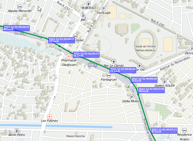

Annotations
Indicate whether you want annotations to be displayed. Annotations are hints which are attached to each point of the track to show the date and time when the message was received, as well as the speed of the movement of the unit at that time. Annotations are rather informative but they make the visual perception of the track more complicated. That is why sometimes it is reasonable to switch them off. Full information about any point of the track can be obtained from the tooltip that appears when you hover the cursor over a point.
The system of measures in the annotations depends on the settings of the current user, not on the settings of the unit.
