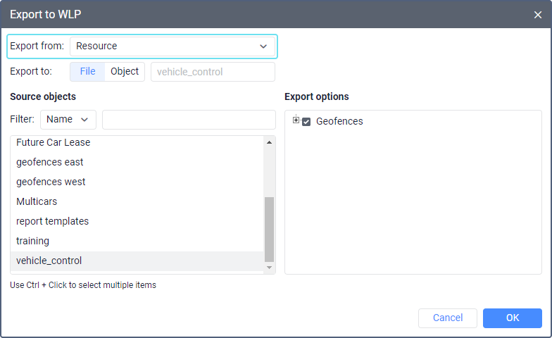

You can export the contents of one resource to another or save the contents to a WLP file using the import and export tool.
You can export any contents of a resource:
  • drivers
  • geofences
  • jobs
  • notifications
  • report templates
To export resource contents, select the Export to WLP item in the user menu and select Resource in the Export from drop-down list. See a detailed guide here.
To add the contents of one resource to another using a WLP file, select the Import from WLP item in the user menu and follow the guide.
