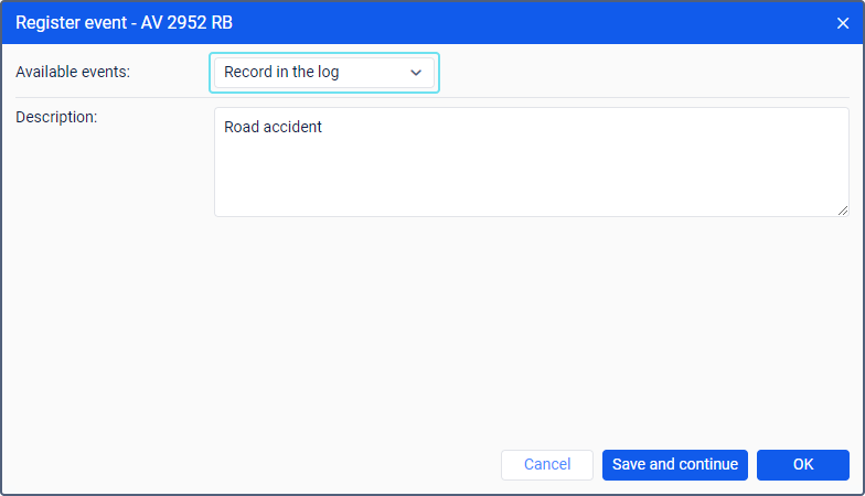

Record in the log
Using this option, you can add any text note to the unit log. It will be labelled as Manual record and dated by the time of creation.

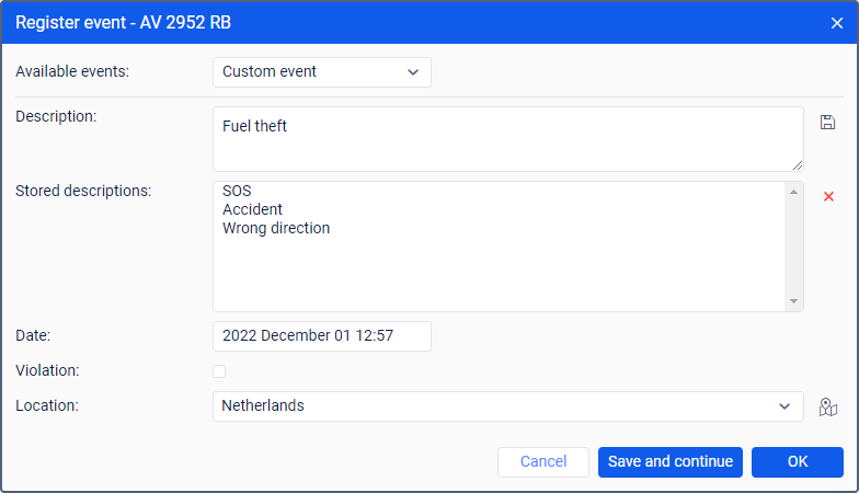

Custom event
To register a custom event, enter its name, description, and location. To add the location, click on the icon  to the right of it. On the map that appears, double-click on the required position. In addition, the position can be entered manually. To clear the field, delete the address.
The description of the registered event can be saved. To do this, click on the Save icon to the right of it. The saved description appears in the list below. To select an existing description, click on it. To delete a description from the list, select it and click on the Delete icon.
If you check the Violation option, the event will be registered in the unit history as a violation, otherwise, it will be registered as a simple event.

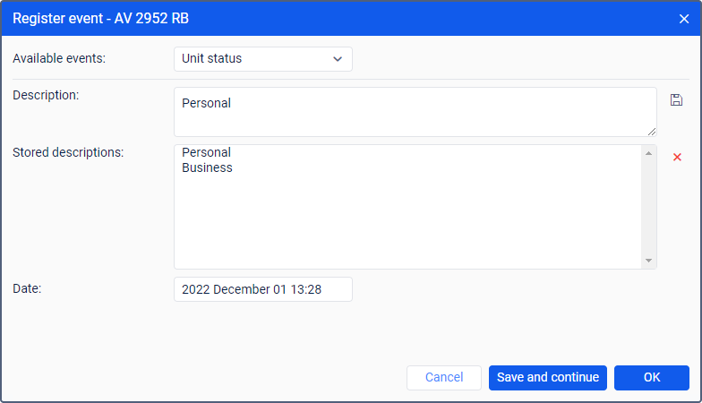

Unit status
This option allows registering the unit state which can be later displayed in reports. For example, when using a vehicle for personal and official purposes, you can register the start of personal or official use of the vehicle.
To register the unit status, type in a description (you can use the ones saved previously) and, if necessary, change the date and time of the status.
