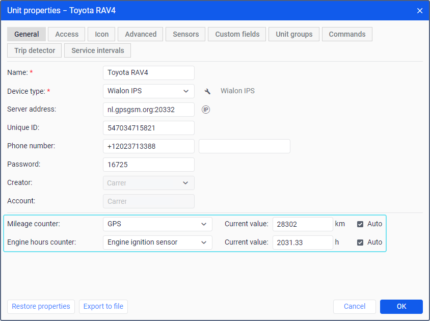

On the General tab, apart from other properties, you can configure the mileage and engine hours counters.
Mileage counter
You can select one of the following mileage calculation methods:

Engine hours counter
The counter of engine hours calculates the working time based on the following sensors:

Counter values
In the Current value field opposite each counter, you can specify the value from which mileage and engine hours should be calculated. Enable the Auto option to the right of the field in order for new data to be added to this value automatically.
To reset counter values manually, type 0 in the Current value field.
