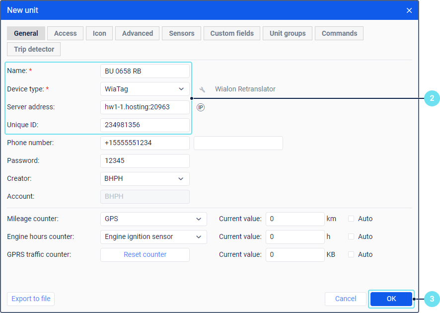

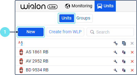

Select the Units mode using a switch and click New.
Specify the unit properties. To connect a unit to the system, you should fill in at least the following fields on the General tab:
- Name;
- Device type;
- Unique ID.
Save the changes.

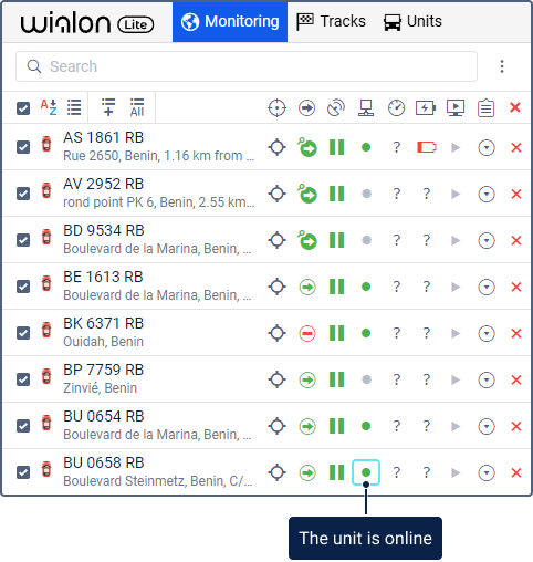

Go to the Monitoring tab to which the created units are added automatically. Make sure the unit is connected and is sending messages to the system. In this case, a green marker is shown in its row in the Connection status column of the list.

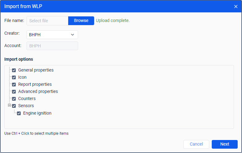

Creating a unit from a WLP file
If you have a WLP file with saved unit properties, you can create a unit with the properties already configured. To do this, click Create from WLP, select the file and the settings you want to add to the unit properties, and click Next.
As a result, a new unit is created and its properties open.
If the device type specified in the WLP file is not available for your account, then the device type of the created unit is automatically changed to Wialon Retranslator.
