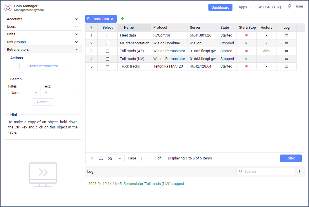

You can work with retranslators only in the Retranslators section of the management system. Here you can perform the following actions with them:
- creating;
- editing properties;
- starting and stopping;
- deleting.
To find a retranslator quickly, use a dynamic search.
The table of the section contains all the created retranslators. You can select table columns in the menu that opens after clicking on the icon
in the table header. The following columns are available in the menu:
| Column | Description |
| # | The sequence number of the retranslator in the table. |
| Select | The checkbox for selecting the retranslator. |
| Name | The name of the retranslator. |
| Creator | The user who has created the retranslator. |
| Account | The account in which the retranslator has been created. |
| Protocol | The protocol using which unit messages are transmitted to another server or system. |
| Server | The server to which unit messages are transmitted. |
| Status | The state of the retranslator: started or stopped. |
| Start/Stop | The icon for starting ( ) or stopping ( ) the retranslator. The same button is available in its properties. |
| History | When transmitting data for a past period, this column shows the percentage of units for which data transmission has already ended. The progress is counted for each unit and increases only after a unit sends all its messages for the selected period. For example, if there is only one unit in the retranslator, the value stays at 0% while its messages are being sent and changes to - as soon as the transmission for this unit ends. |
| Log | The icon which opens the retranslator log. |
You can sort the data in the table by any column. To do this, click on the column header.

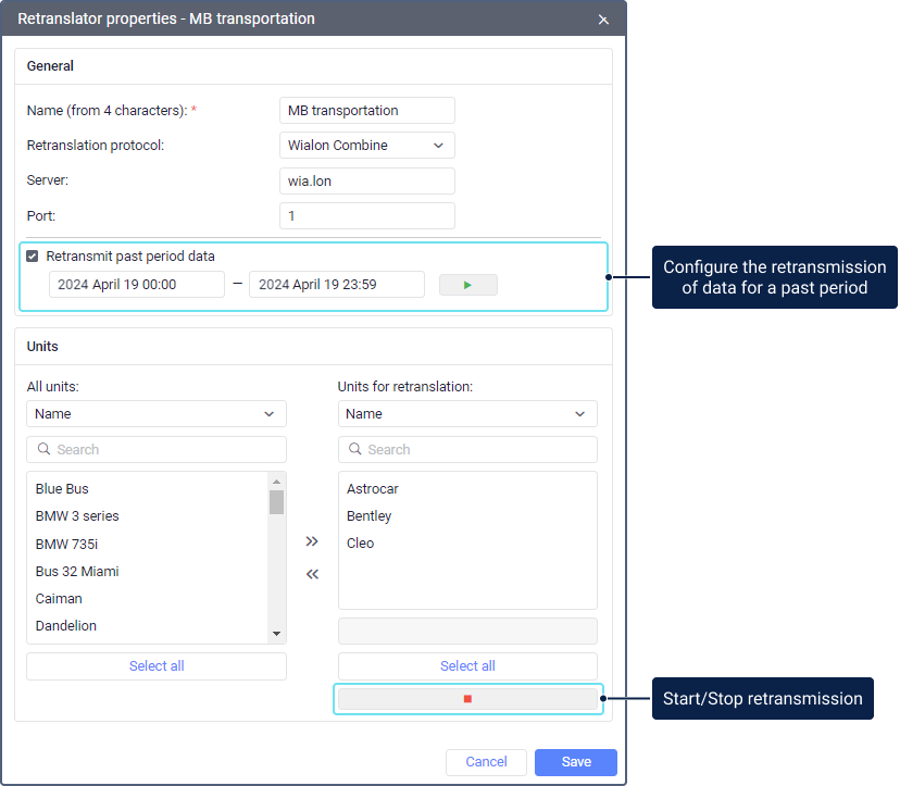

To open the properties of a retranslator, click on its row. The window of the properties is similar to the retranslator creation window. The only difference is that the properties contain the Retransmit past period data option, as well as the button
for starting and stopping data transmission.

Retransmitting data for a past period
To transmit unit messages for a past period, follow these steps:
- In the retranslator properties, enable the Retransmit past period data option. The option is available only if the retranslator is started.
- Specify the period for which you want to transmit data.
- Click on the button
to the right of the specified period.
It may take up to 10 minutes to start retransmitting data for a past period.
The percentage of units for which data transmission has already ended is shown in the History column of the retranslator table.
