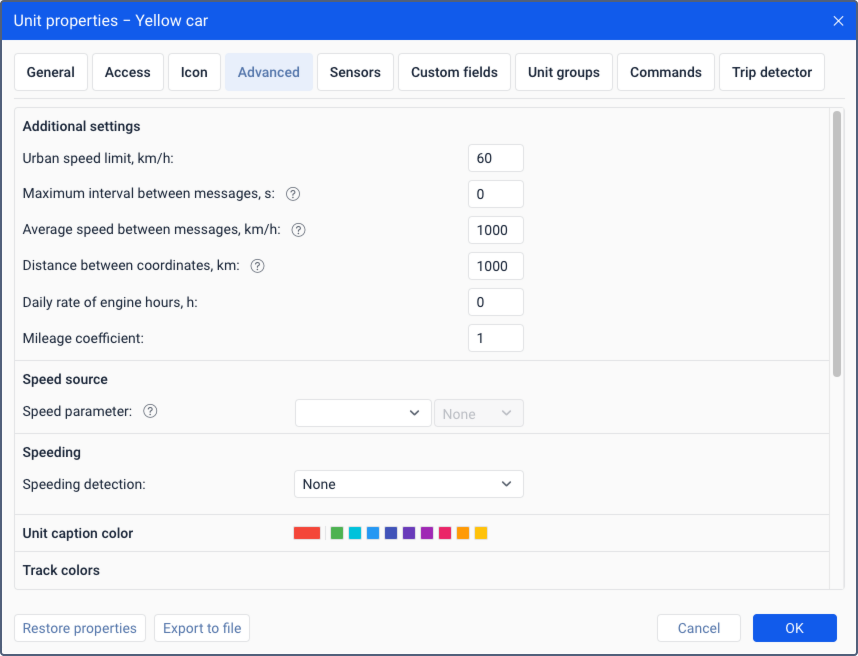

Additional settings
The parameters available in this section influence the calculations of mileage, engine hours and other data.
Parameter Description
Urban speed limit The maximum speed at which it is conventionally considered that the unit is moving within the city. Moving at a higher speed is considered as suburban mileage.
Maximum interval between messages The maximum interval between messages in seconds. If the specified value is exceeded, the system considers it as connection loss.
Average speed between messages This option is used to exclude coordinate outliers when calculating mileage.
Maximum average speed of the unit determined by two successive messages, in km/h. If the specified value is exceeded, these messages are not taken into account when calculating the mileage in reports and in the GPS and GPS + engine ignition sensor mileage counter.
To disable the option, specify 0.
Distance between coordinates This option is used to exclude coordinate outliers when calculating mileage.
Maximum distance between coordinates in two successive messages, in km. If the specified value is exceeded, these messages are not taken into account when calculating the mileage in reports and in the GPS and GPS + engine ignition sensor mileage counter.
Daily rate of engine hours The daily rate of engine hours (in hours). This value can be used in the report on engine hours (when calculating utilization and useful utilization). The operation of engine hours is determined by the engine hours counter.
Mileage coefficient The coefficient used to correct the mileage calculated in the system in cases where it always differs from the actual mileage by a certain number of times.
Example. The mileage calculated in the system is 100 km, and the actual mileage (determined by the vehicle equipment) is 120 km. The mileage coefficient that should be specified in this field is 120/100 = 1.2.
The result of multiplication by the coefficient is shown in the Mileage (adjusted) column in the Geofences report table.

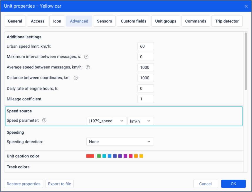

Speed source
This section is shown for certain device types for which changing the speed source is supported in the monitoring system.
In most cases, the monitoring system uses the values calculated by the device via GPS as speed values. They are stored in the unit messages in the speed parameter. If they are not correct, you can specify the parameter the values of which should be used for the speed parameter.
To set the speed source correctly, follow the steps below.
  1. In the Speed parameter field, select or specify the name of the parameter (no more than 50 characters) the values of which should be used as speed values. The list shows all the parameters sent by the device, except for the virtual ones.
  2. Select the unit of measurement in which the device sends speed values (not the unit of measurement which should be shown in the monitoring system). If the unit of measurement is not selected, the system uses km/h.
  3. Save the changes.
After that, the speed parameter values from the unit messages begin to be replaced by the values of the specified parameter in all parts of the system without the possibility of recovery. If the messages don’t contain the specified parameters, the usual values of the speed parameter are used.

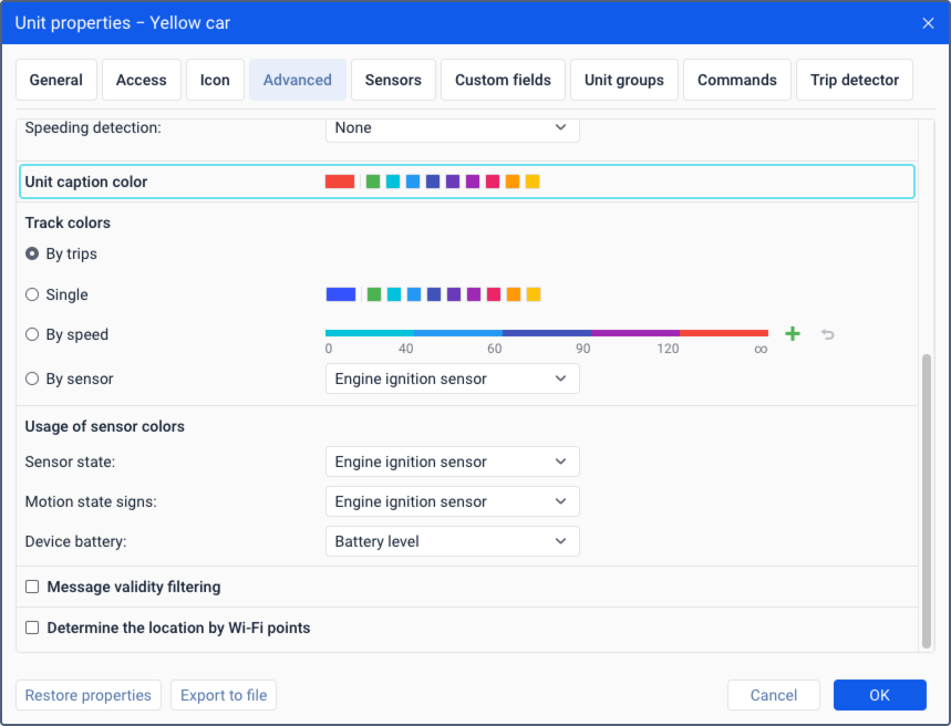

Unit caption color
By default, the names of the units are shown on the map in red. However, you can select a different color for each unit.

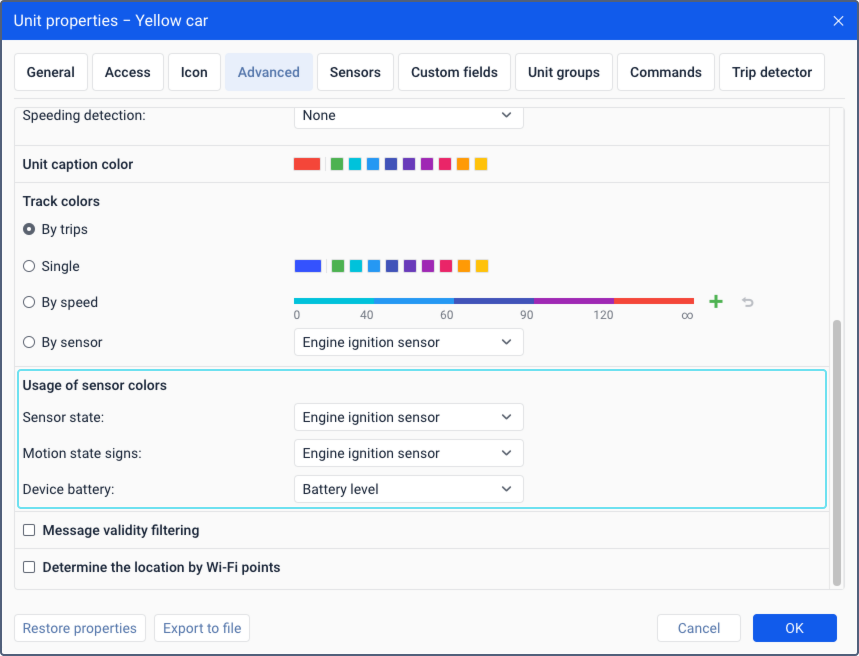

Usage of sensor colors
In this section, you can select the sensors the colors of which should be used for certain interface elements. The colors are configured in the sensor properties.
Below are the interface elements for which the colors of the selected sensors are used.
Item Description
Sensor state The colors of the selected sensor are used for the Sensor state option in the work list on the Monitoring tab and in the menu of monitoring options on the map.
Motion state signs The colors of the selected sensor are used for motion state signs on the map.
Battery level The colors of the selected sensor are used for the Device battery option in the work list on the Monitoring tab and in the menu of monitoring options on the map.
If the unit doesn’t have suitable sensors, these options are inactive.
