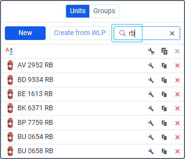

If the list contains many items, it may be difficult to quickly find the required one. For convenience, you can use the dynamic search available on most tabs. Start entering the name of the object (geofence, unit, and so on, depending on the active tab). You can type just a part of the name. As you enter the text, the list shows the items that match your query. The search is not case-sensitive.
If you leave the filter field empty, all the available items will be displayed in the list.
You can also use the dynamic filter when adjusting the access rights on the Access tab of the user, unit, and unit group properties. Moreover, you can use the dynamic filter to select a resource when creating notifications, jobs, report templates, geofences.

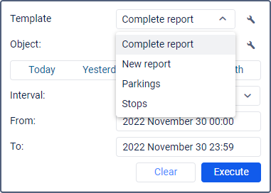

When building tracks or querying reports, you can use dynamic search in dropdown lists. For tracks, you can quickly find a necessary unit in the dropdown list, for reports you can find templates or objects. To use the dynamic search, click the corresponding dropdown list and start entering the name. You can use a wildcard character asterisk (*) to facilitate the search. As a result, the dropdown list is filtered according to the indicated symbols.
To work with the dropdown list, you can use a keyboard. Use arrows (up/down) for navigation through the list and the Enter key for choosing a necessary item.

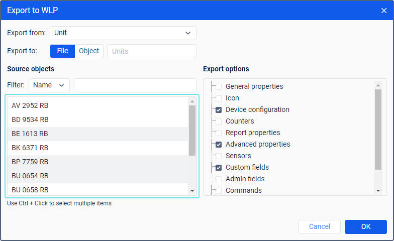

Multiple selection list box
In the lists of such type, you can select multiple items. To choose several items throughout the list, hold the Ctrl button, and consequently click on the necessary items.
Moreover, the following keys and their combinations can be used:
  • Home: move to the beginning of the list;
  • End: move to the end of the list;
  • <⇑> (up arrow): move to the previous item;
  • <⇓> (down arrow): move to the next item;
  • Ctrl + A: select all;
  • Shift + Home: select everything from the current place to the beginning of the list;
  • Shift + End: select everything from the current place to the end of the list;
  • Shift + ⇑: consequently select the items going up from the current one;
  • Shift + ⇓: consequently select the items going down from the current one.

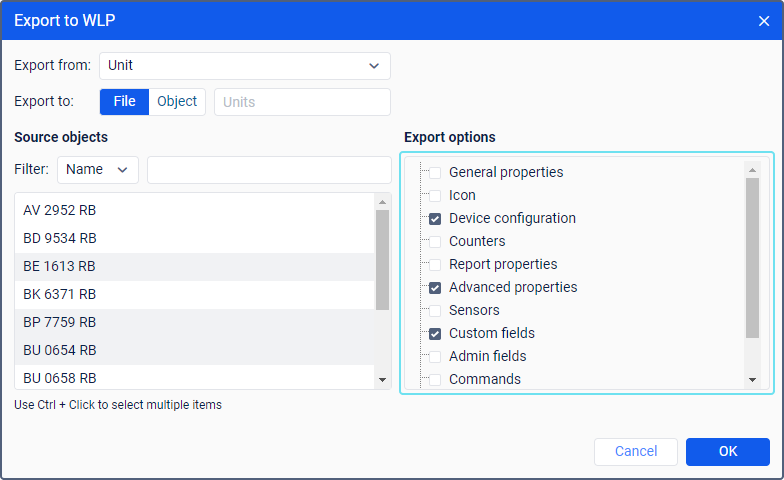

Checkbox list
Multiple selection lists may contain checkboxes indicating whether the item is selected or not. The Ctrl + click combination can be used in such lists in order to check/uncheck all the items at once.
