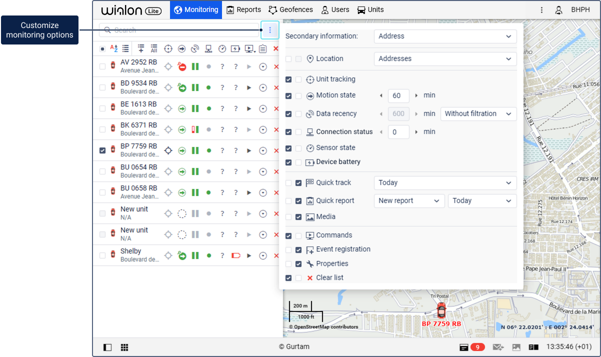

To customize the list, press the icon
in the upper right corner of the Monitoring tab. In the left column, select the options that should be displayed in the work list and in the monitoring options menu. In the right column, you can select the options that are used more rarely — they will be shown in the additional menu and will be available there.
All the options on the Monitoring tab can nominally be divided into two types described below.
Of information. These icons contain some information about the current state of the unit (movement/stop, sensor value, connection status, data recency). For additional information, see the tooltip which appears when you hover the mouse cursor over the icon.
Of action. A click on these options allows performing an action on the unit (event registration, command or report execution, message request, track building, properties editing, removal from the work list, etc.). As a rule, all further instructions can be found in the corresponding dialog boxes. Active action buttons turn blue when you mouse over them.
