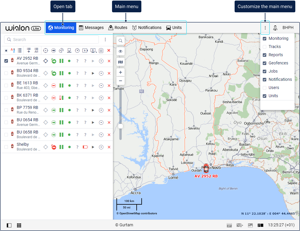

The width of the work area can be changed. To do this, click on its right border and drag it to the required direction, holding the mouse button. Moreover, you can hide the work area by pressing the button located in the lower left corner .
To adjust the main menu, click on the customizer icon  and select the menu items you want to work with. The selected items immediately appear in the top menu.
The open tab is highlighted with a darker background. To navigate through the menu, click on the required name. The contents of the left panel (the work area) change automatically.
All the range of items selected for the main menu is displayed at the top. The names of the tabs are shortened if there is a lack of space. That is why you should select only those items that you actually use.
Alternative means of navigation
If the browser window is small, but there are a lot of tabs selected, inscriptions generally become not visible, and menu tabs are presented just with icons. In such cases clicking on the icon mostly leads to switching on/off the layer on the map. Therefore, in such cases to switch the tabs you should additionally hold the Ctrl key.
Another means of navigation is through the menu settings window. If you click on the name of any item in the settings window, you will be taken to the corresponding tab. In this case, if before it was not displayed in the menu, it appears. Also, do not forget that when you open the tab from the menu settings window, the tab layer is activated automatically.
The same occurs in case of forced transitions between tabs, for example, when requesting a report from the Monitoring tab. Even if the requested tab is not displayed in the main menu, the transition is successful. In this case, the corresponding item is added to the menu and the layer becomes active.
