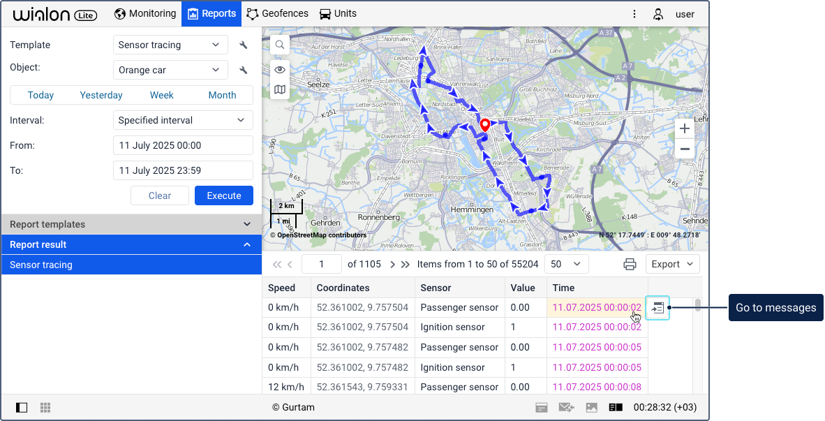

Going to messages and places on the map
From a report table, you can navigate to messages and their corresponding points on the map.
The address and coordinates in the table are blue, while the time values are lilac (for messages with coordinates). When you click on such cells, the corresponding place on the map is indicated with a marker.
When you click on a lilac time value, you can see the icon which allows you to go to the table of data messages. The message received at the selected time is shown first in the table and has a gray background, and the place of its sending is indicated on the map with a marker. To hide the icon , right-click on it or press Esc.
If a time value is black, the features described above are unavailable, as there is no location data.
