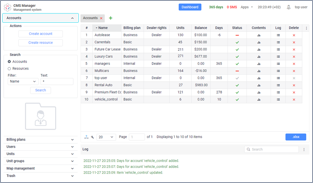

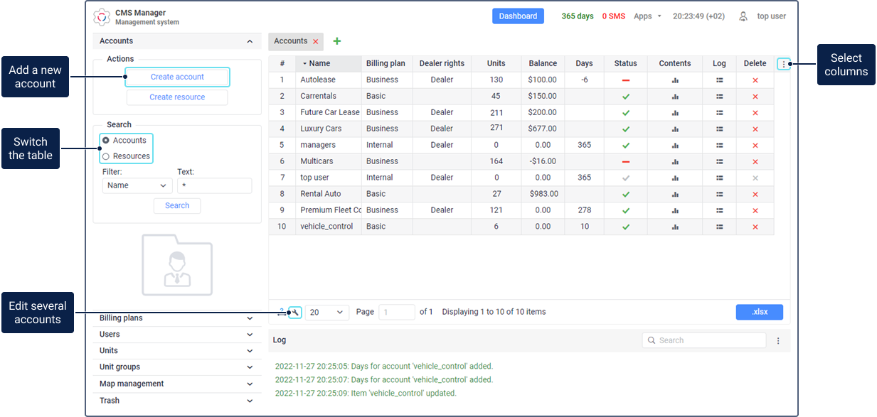

Table of accounts
By default, the section shows the table of all the available accounts. To open the table of resources, use the switch in the Search block.
To show or hide columns, click on the icon
in the heading of the table with accounts. In the menu, the following columns are available:
| Column | Description |
| # | The sequence number of the account in the table. |
| Name | The name of the account in the system. |
| Creator | The user on whose behalf the account was created. See more about the creator. |
| Account | The parent account. |
| Billing plan | The billing plan assigned to the account. |
| Dealer rights | The dealer rights, if granted. The lines of accounts with dealer rights indicate Dealer. |
| Units | The total number of all activated and deactivated units belonging to the account and its subordinate accounts, if any. |
| Activated units | Not applicable in the system. |
| Balance | The current balance of the account. |
| Days | The number of days before the account is blocked, if blocking by days is configured for it. To see the date, point to the number of days. The days can be highlighted in two colors:
| Status | The status of the account: active ( ) or blocked ( ).If you have Full access, the icons also allow you to block or activate the account directly from the table. |
| Blocked | The blocking date of the account, if it is currently blocked. |
| Contents | The icon which allows you to run a quick report on the account contents. |
| Log | The icon which allows you to open the log of the account. |
| Delete | The icon which allows you to delete the account. The icon is active if you have the Full access preset. |
To open the properties of an account, click on its line in the table. Depending on your access rights, the window of the account properties may contain up to seven tabs.

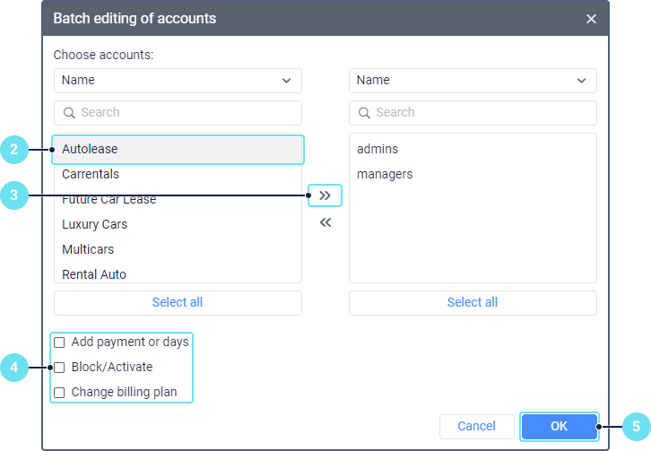

Batch editing of accounts
You can edit some settings in the properties of several accounts at once. To do this, follow the steps below.
Click on the icon
in the tool panel below the list of accounts. -
In the left list, select the account the properties of which you want to edit. To search for them, use the dynamic filter. To search by the name of creator, account, billing plan, custom or administrative fields, select the corresponding option in the list above the search.
Move the selected accounts to the right list by double-clicking them or using the icon
Select one or more required actions from the three available ones:
- Add payment or days. Allows you to change the balance of the accounts or add days (a comment is required).
- Block/Activate. Allows you to block or activate the accounts.
- Change billing plan. Allows you to assign another billing plan to the accounts.
- Click ОК.

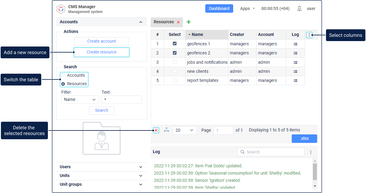

Table of resources
The table of resources contains all the available resources created manually. To open it, activate the Resources switch in the Search block and click on the Search button.
in the heading of the table with resources. In the menu, the following columns are available:
| # | The sequence number of the resource in the table. |
| Select | The selection of the resource. |
| Name | The name of the resource in the system. |
| Creator | The user on whose behalf the resource was created. |
| Account | The account to which the resource belongs. |
| Log | The icon which allows you to open the log of the resource. |
To delete a resource, select it in the table and click on the icon
in the tool panel.
To open the properties of a resource, click on its line in the table. If you have Full access, you can work with the General, Access, and Custom fields tabs.
You can save the contents of any resource to a file or copy the required objects to another resource. Read more here.
