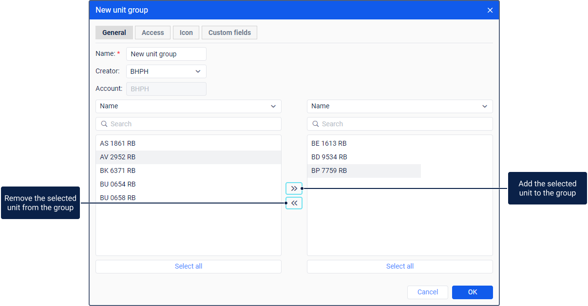

General
On this tab, you can specify the basic properties of the group and add or remove its units.
The required fields are marked with an asterisk (*).
| Property | Description |
| Name* | The name of the unit group (4–50 characters). It shouldn’t contain " (double quotes), { } (curly braces), and \ (backslash). Read more about the rules here. |
| Creator | The user on whose behalf the group has been created. You cannot change this property after saving a new group. Read more about the creator here. |
| Account | The account to which the group belongs. You cannot change the account because it is specified automatically. |
| Units | The left list shows all the available units. The right list shows those units which have already been added to the group.To change the number of units added to the group, you should have full access to it. To quickly search for units by name, use the dynamic filter. To search by other unit properties (for example, unique ID, device type, etc.), select the corresponding option in the drop-down list above the search. To add a unit to the group, move the unit from the left list to the right one; to remove, vice versa. To move units, use the icons / or double-click on the selected units.To select several units, hold down Ctrl and select the required ones. To select all the units in the list at once, click Select all. |

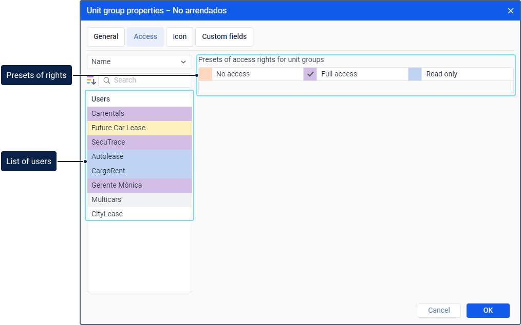

Access
To work with this tab, you should have full access to the group and to the units from this group.
On the tab, you can grant to users access rights to the group. These rights also apply to all the units added to the group.
In the left part of the window, you can see the list of users to whom you can grant access rights to the group. The names of users who have access rights presets are highlighted in color.
In the right part of the window, you can see the presets that you can assign to the user.
Read more about access rights here.

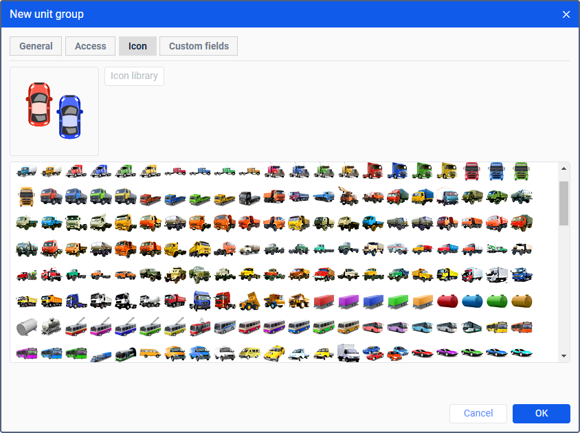

Icon
To view this tab and change the group icon, you should have full access to the group.
On the tab, you can choose an icon which should be used to identify the group in the lists of other groups.
You can use either standard or custom icons. To choose a standard icon, click on the Icon library button. To upload a custom icon, click on the chosen icon, select the image on the disk, and click OK. Supported formats are PNG, JPG, GIF, and SVG. The recommended image size is 32×32 pixels. To replace the icon with a standard one, point to the image and click on the icon

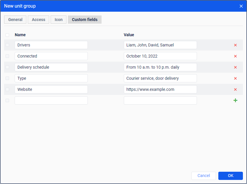

Custom fields
To view information on the tab, the user must have the Read only preset of access rights. To make and save changes on the tab, the user must have full access.
On this tab, you can create custom fields with additional information about the group or units added to it.
To create a custom field, fill in the Name and Value fields and click on the icon
. The Value field is optional. After saving the changes on the tab, all custom fields are displayed in alphabetical order.
To delete a custom field, click on the icon
next to it.
