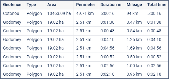

The table can include the columns described below.
| Column | Description |
| Geofence | The name of the geofence. |
| Type | Polygon, line, circle, unit (if units are selected instead of geofences in the report template). |
| Area | The total area of the geofence (if the metric system is used, the area will be indicated in hectares). |
| Perimeter | The perimeter of the geofence. The perimeter for a line is its length (line thickness is not taken into account). |
| Description | The description of the geofence (taken from the geofence properties). |
| Time in | The time when the unit entered the geofence. |
| Time out | The time when the unit left the geofence. |
| Duration in | The duration of the visit. |
| Total time | The time from the beginning of the first visit to the end of the last one. |
| Parkings duration | The time spent in parkings. |
| Off-time | The time between leaving and entering one and the same geofence. It is determined if the unit visited the geofence at least two times. |
| Mileage | The mileage inside the zone. |
| Initial engine hours | The value of the counter of engine hours when the unit entered the geofence. |
| Final engine hours | The value of the counter of engine hours when the unit left the geofence. |
| Avg speed | The average speed with which the unit moved in the geofence. |
| Max speed | The maximum speed with which the unit moved in the geofence. |
| Visits | The number of visits (can be helpful either in grouping table data by years/months/weeks/days/shifts or for the reports on unit groups). |
| Notes | An empty column for your custom comments. |
