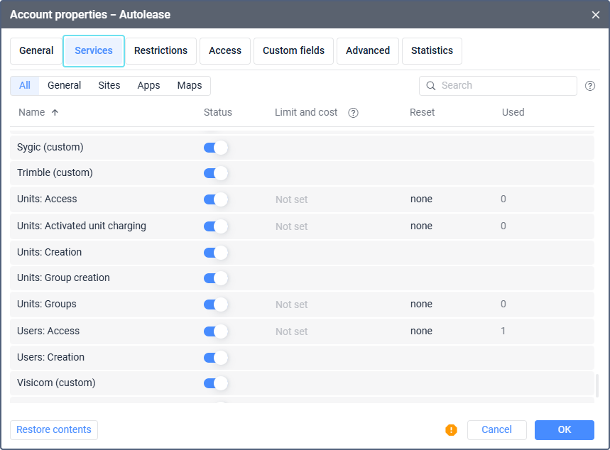

Services
To view information on the Services tab, it is mandatory to have the Read Only access preset assigned to the account. To make and save changes to the tab, the user must have full access.
The tab displays all the services available for the account. The list of services depends on the billing plan selected for the account and the activated modules. Here you can enable and disable services for the account as well as set their limit and cost.
To find the service by its name, start typing in the dynamic search field.

Service settings
Depending on the selected filter, the list of services can consist of the following columns:
Column Description
Name The name of the service. See the full list of services and their description here.
Status The state of the service. Click on the button to disable or enable the service.
The deactivation of a service in a billing plan leads to its automatic deactivation in the account to which this plan is assigned. However, if the state of the service is additionally changed in the properties of the account, then it is given priority.
An account user does not have access to services that are disabled in a parent account.
To reset the default status, click on the icon restore in the service row. The default status is taken from the billing plan assigned to the account. The icon isn’t active unless you have changed the status or edited the values in the Limit and cost column.
Limit and cost In the Limit and cost column, you can specify the maximum quantity or quantity and cost of the service. See the examples and how to fill in the field correctly.
The values of the Limit and cost field can be greater than those in the billing plan properties, but not greater than the values from the Limit column.
The default values are taken from the billing plan assigned to the account. To reset the default values, click on the icon restore in the service row. The icon isn’t active unless you have changed the status or edited the values in the Limit and cost column.
Reset Here you can select how often the specified service limit should be reset: hourly, daily, weekly, or every calendar month (monthly). After the end of the selected period, the value in the Used column is reset to zero.
Example. The Limit and cost field specifies 10, and the Reset field specifies daily for the SMS messages service. In this case, the user can send no more than 10 messages each day.
Used This column shows how many objects (units, drivers, etc.) are already created in the account and in its subordinate accounts, if any. For uncountable types of services, such as Management system (CMS Manager), nothing is shown in the column.
The value resets after the period selected in the Reset column.
You can sort the services by their name and status by clicking on the column heading.
