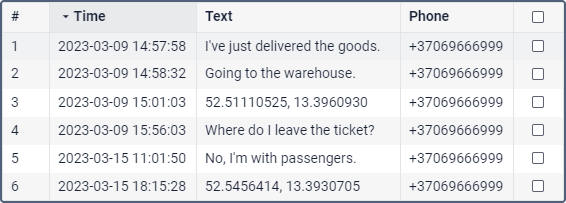

When you request this type of messages, you can see a table with the SMS messages sent to the server by the unit when executing commands, triggering the alarm, and in other cases depending on the device configuration.
The table can contain the following columns:
Column Description
Time The date and time of sending the message.
Text The text of the message. You can filter the messages by text.
Phone The phone number of the tracker SIM card from which the message was sent.
