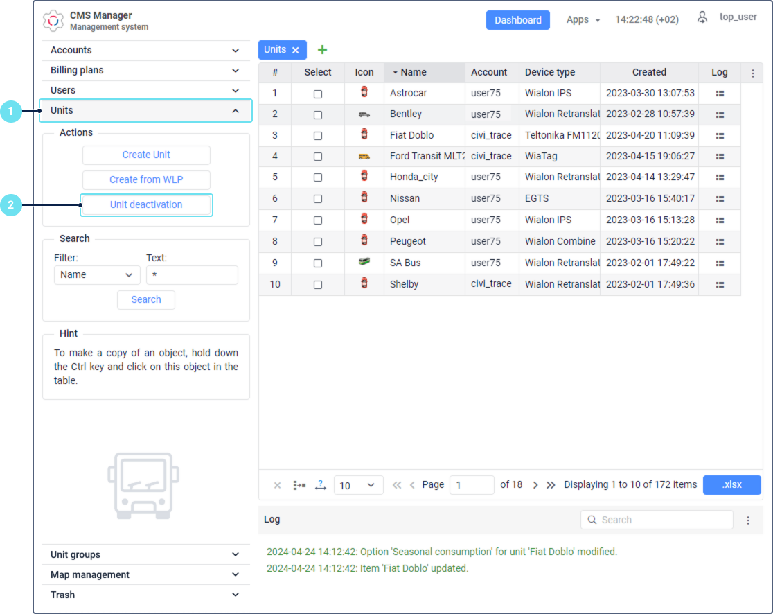

  1. Open the Units section.
  2. Click on the Unit deactivation button.

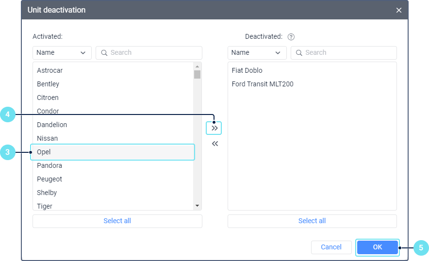

  3. In the left list, select a unit you want to deactivate. To find it, use the dynamic filter above the list.
  4. Move the selected unit from the left list to the right one using the icon right-arrow icon or by double-clicking the unit.
  5. Click OK.

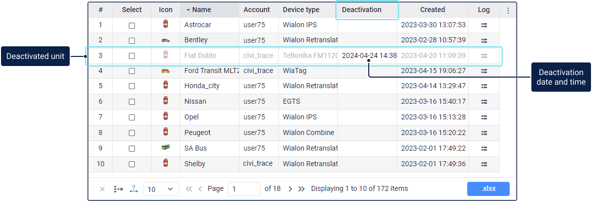

The lines with deactivated units are highlighted in light grey in the table. The date and time of deactivation are displayed in the Deactivation column.
To open the properties of the deactivated unit, click on the line with it. In this case, you cannot edit them.

To activate a unit, follow steps 1–5 for the deactivation, but in step 3, select the unit in the right list, and move it to the left one using the icon or by double-clicking the unit.
