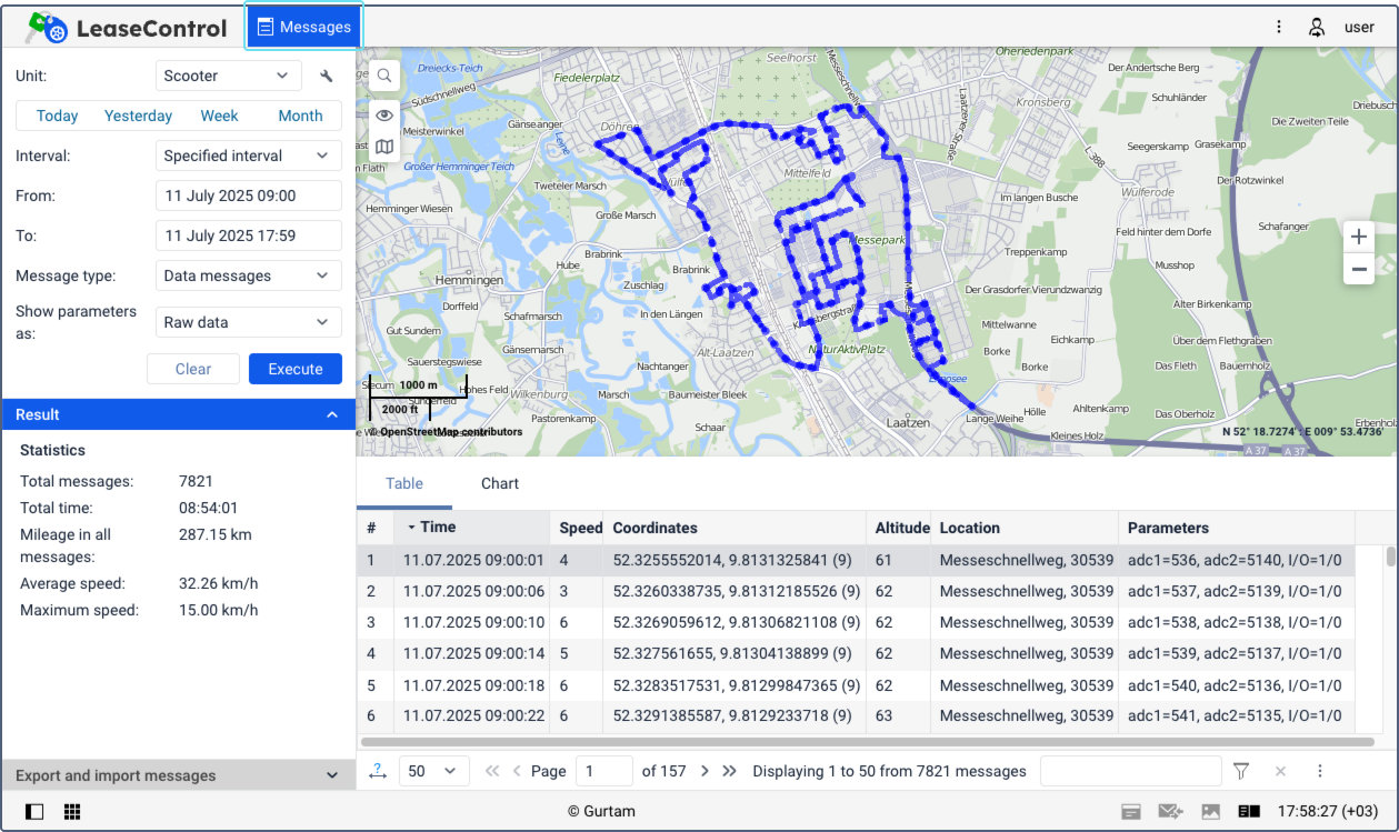

Tab interface
The Messages tab interface is divided into four main blocks:
  • Top left: Parameters for requesting messages are configured.
  • Bottom left: Statistics for the current query are displayed, along with options for importing and exporting messages.
  • Top right: The map is located.
  • Bottom right: The messages resulting from the executed query are displayed.
The sectors can be resized (the left ones — in width, the right ones — both in width and height). To do this, click on the border between them with the left mouse button and while holding it, move the border to the right/left or up/down. At the same time, if less than 10% of the map is left while expanding the lower sector, the map automatically collapses. To return it, press on the line under the top panel.
