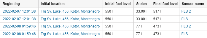

This report table allows you to find out when and where fuel thefts occurred. They are detected during stops and while the unit is parked, as well as while it is moving, provided that the Detect fuel theft in motion option is enabled. The parameters for this report are set in the properties of fuel level sensors.
The columns available in the table are described below.
ColumnDescription
BeginningThe date and time when the theft began.
Initial locationThe unit's location at the time of the beginning of theft.
TimeThe moment of the most significant drop in the fuel level.
Final locationThe location of the unit at the time of the fuel theft (the Time column).
Initial fuel levelThe fuel level before the theft.
Initial speedThe speed at the time of the beginning of theft.
StolenThe stolen fuel volume.
Final fuel levelThe fuel level after the theft.
Final speedThe speed of movement at the time of the fuel theft (the Time column).
Sensor nameThe sensor that detected fuel theft.
DriverThe name of the driver (if identified).
TrailerThe name of the trailer (if it was assigned).
CountThe number of thefts.
CounterThe counter sensor value.
MileageThe mileage sensor value at the moment of theft. If the mileage parameter was not saved throughout the reported period, the mileage is counted from 0.
Avg value of custom sensorThe average value of the custom sensor registered during the theft.
Min value of custom sensorThe minimum value of the custom sensor registered during the theft.
Max value of custom sensorThe maximum value of the custom sensor registered during the theft.
Initial value of custom sensorThe value of the custom sensor registered before the theft.
Final value of custom sensorThe value of the custom sensor registered after the theft.

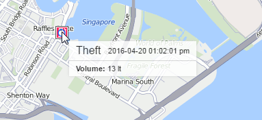

Special markers can be shown on the map in the places of thefts.
