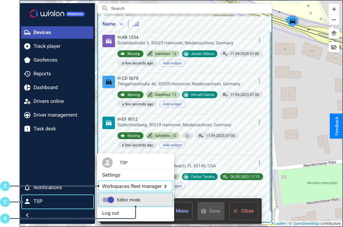

  1. Log in to Wialon Platform FleetSpace as the customer.
  2. (Optional): Click on the service provider name in the left bottom corner to ensure the required workspace is selected. If you need to create a new workspace, see the guide on creating a new workspace.

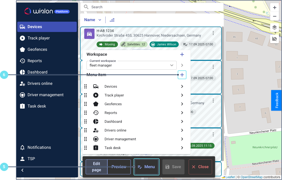

  4. If the sidebar is collapsed, expand it using the icon .
  5. Click New page.

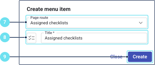

  6. In the Source page field, select Assigned checklists or Submitted checklists.
  7. Modify the icon and name of the section if needed.
  8. Click Save.
  9. Repeat steps 5-8 for the other checklist page.
  10. Click the icon in the editor mode toolbar to apply the changes to the workspace.

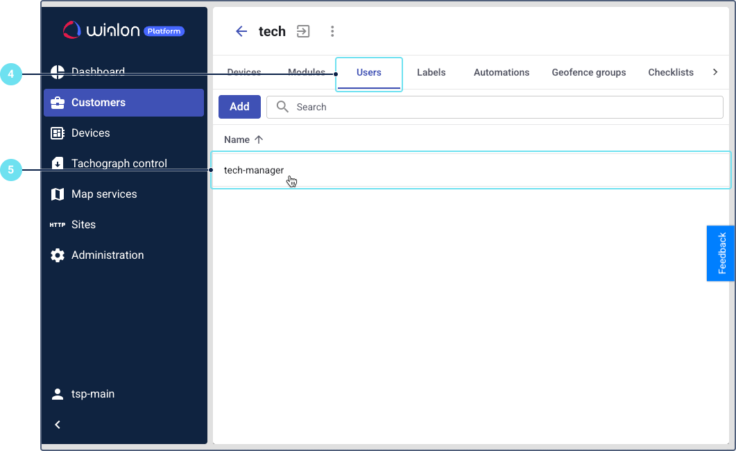

  1. Log in to Wialon Platform Studio.
  2. Navigate to the Customers page from the main menu.
  3. Select the relevant customer from the list.
  4. Go to the Users tab within the customer’s details.
  5. Click on the user’s row to open their details.

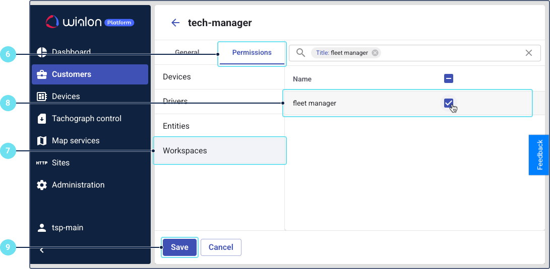

  6. Go to the Permissions tab.
  7. Click on the Workspaces section.
  8. Ensure that the workspace you configured in Wialon Platform FleetSpace is selected for this user.
  9. Click Save to apply any changes to the user’s permissions.
