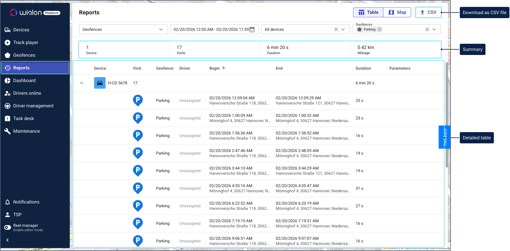

Information available in the report
Once the report is generated, the results page provides a summary section at the top and a detailed table below.
Summary
The summary section at the top of the report shows key statistics for the selected period, devices, and geofences.
Statistic Description
Device Total number of devices included in the report.
Visit Total number of geofence visit intervals.
Duration Combined duration of all visits.
Mileage Total distance traveled during visits.
Detailed report table
The detailed table contains geofence visit intervals grouped by selected devices.
Column Description
Device Device name (parent row, expandable).
Visit Total number of geofence visit intervals for the device.
Geofence Name of the geofence visited.
Begin Start time and address of the visit.
End End time and address of the visit.
Duration Length of the visit.
Parameters Additional interval parameters such as engine hours if the ignition sensor is configured.

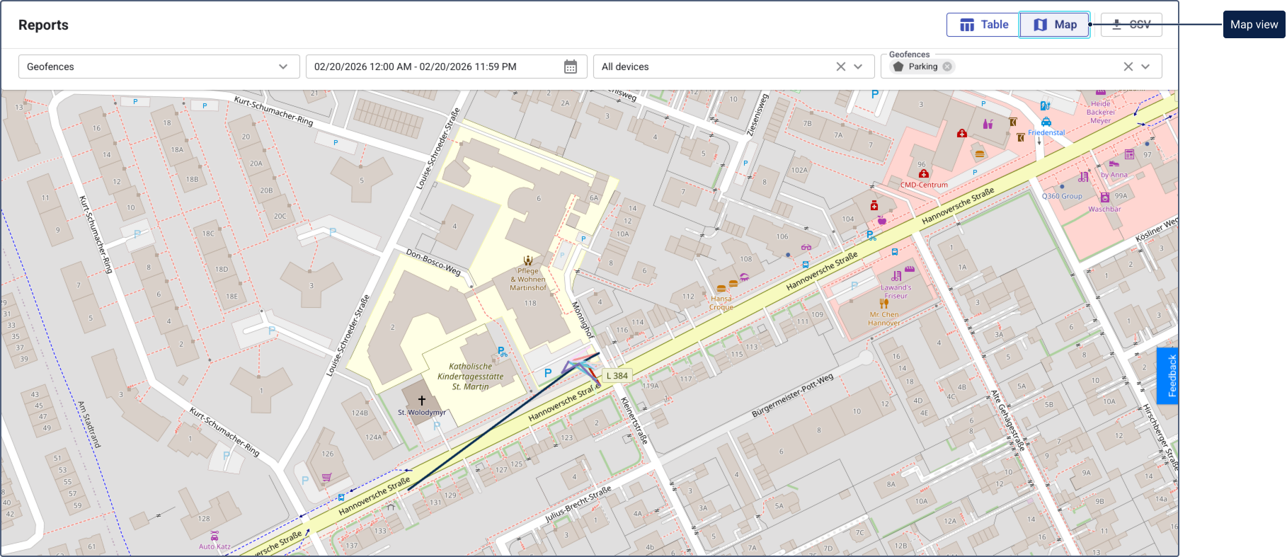

Switching between table and map views
After you generate the report, you can change how the results are displayed:
  • Click Table to view the report as a table.
  • Click Map to view visits on the map.
