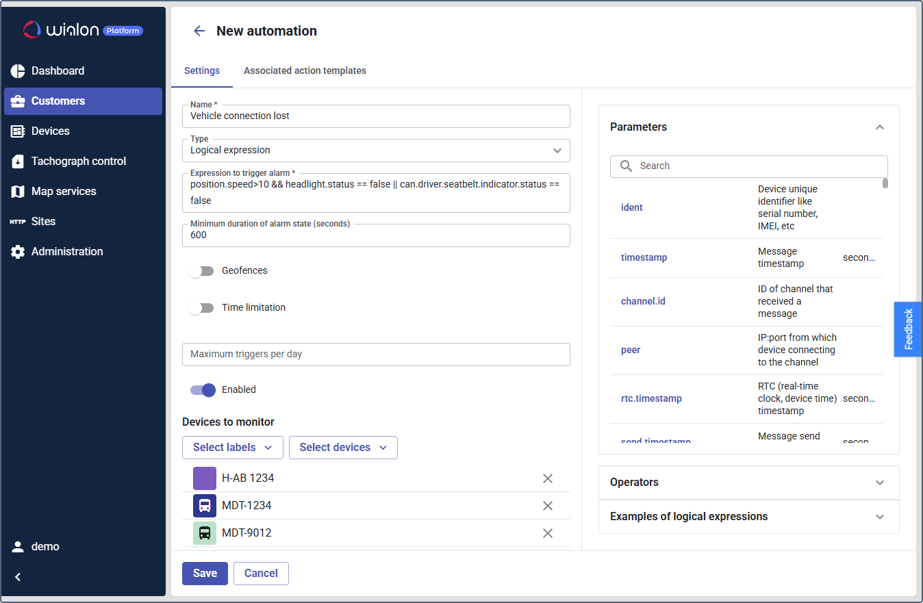

  1. In the customer Automations tab, click the Add automation button.
  2. In the New automation form, on the Settings sub-tab, enter a descriptive name, for example, Driving violations.
  3. In the Type field, select Logical expression.
  4. In the Expression to trigger alarm field, create a logical expression using the section on the right. This section helps you find the necessary parameters and logical operators to join them into an expression. Learn more about the logical expression format.
Use the following expression for driving without headlights or a seatbelt:
Copied!
position.speed>10 && headlight.status == false || can.driver.seatbelt.indicator.status == false
This triggers when the device is moving at the speed greater than 10 km/h with headlights off (false) or when the seatbelt indicator is false (unbuckled).

  1. (Optional): In the Geofences field, select specific geofences and geofence groups to restrict the area where the automation can be triggered.
  2. In the Minimum duration of alarm state field, enter the minimum duration, in seconds.
  3. (Optional): In the Time limitation field, restrict the automation to specific days or hours.
  4. (Optional): In the Maximum triggers per day field, you can limit activations to reduce notification overload.
  5. Ensure the Enabled toggle is active.
  6. Select the devices or groups in the Labels or Devices field.
