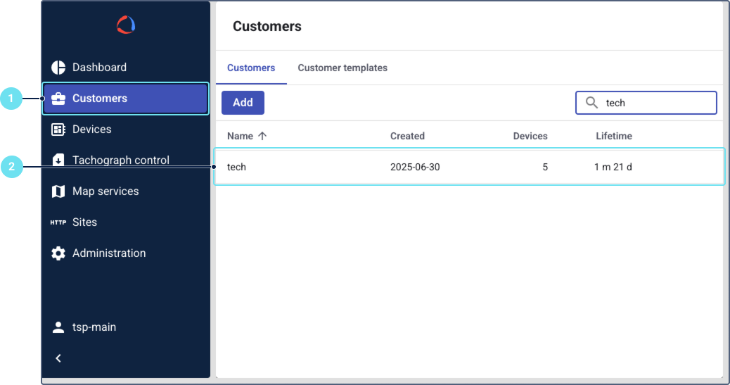

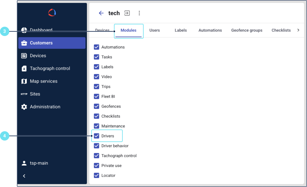

Enabling the “Drivers” module
Where: Wialon Platform Studio
To enable the Drivers module for a customer, assign them a billing plan that includes this feature. See Assigning billing plans to customers for information about the available billing plans and how to assign them.
