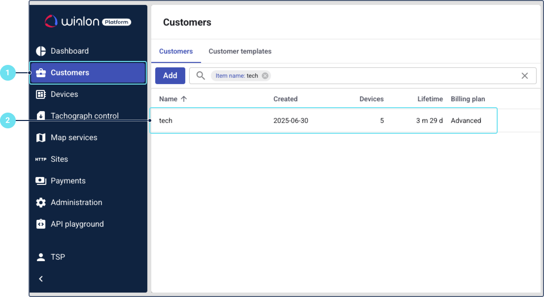

  1. In Wialon Platform Studio, navigate to the Customers page.
  2. Select the customer for whom you want to configure the automation.

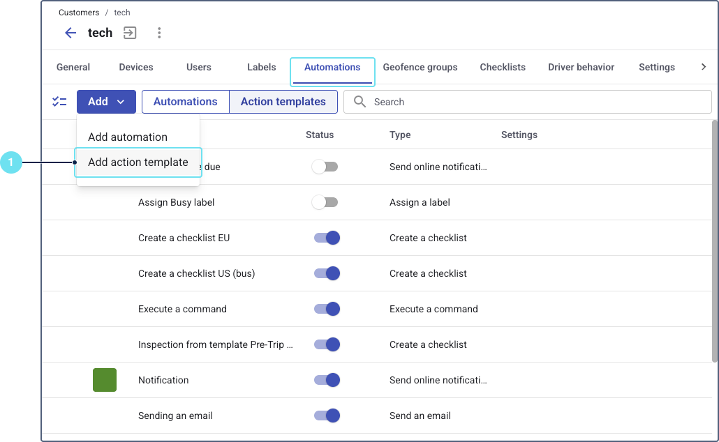

  1. On the Automations tab, switch to the Action templates mode and click New action to create a new action template.

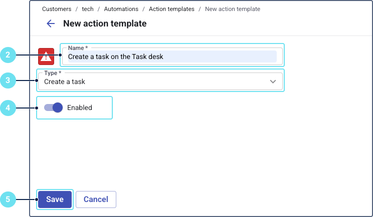

  2. In the Name field, enter a descriptive name for the action template (for example, “Create a task on the Task desk”).
  3. From the Type dropdown list, select Create a task.
  4. Ensure the Enabled toggle is switched on.
  5. Click Save.

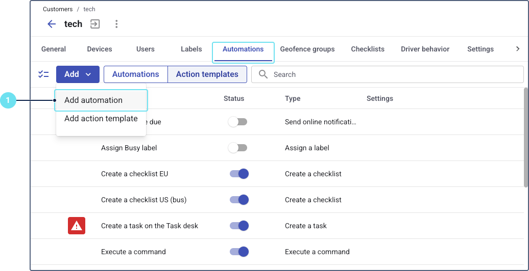

  1. On the Automations tab, click the Add button and select Add automation to create a new automation.

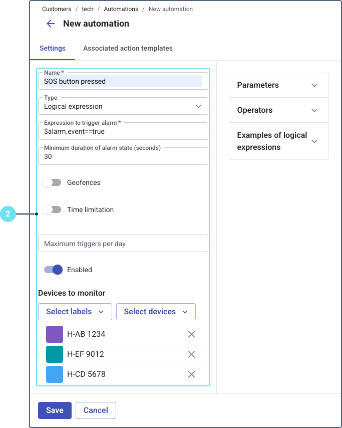

  2. Configure the following parameters for the new automation:
    • Name: Enter a descriptive name for the automation (for example, “SOS button pressed” or “Vehicle outside geofence”).
    • Ensure the Enabled toggle is switched on.
    • Select an Automation type that will trigger the incident. You can use only those automation triggers that have a clearly defined start and end time for an event:
      • Connection loss: To create a task if a device stops sending data for a specified duration.
      • Logical expression: To define complex conditions based on telemetry data (for example, speed exceeding a limit, specific sensor values).
        You can’t use any other automation types for task creation.
    • Configure the parameters specific to the chosen automation type. For example, for Connection loss, specify the Minimum duration of connection loss. For more details, see Automation types and parameters.

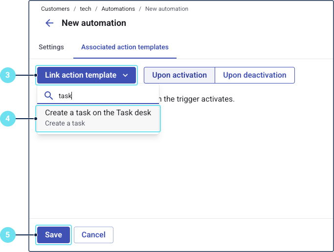

  3. On the Associated action templates tab, click Link action template.
  4. From the dropdown list, select the action template you created earlier.
  5. In the Text field, you can customize the note that will appear in the task. Use the available placeholders to include dynamic information, such as the device name or the duration of the event. For more details, see Using placeholders in the text message.
  6. Click Save.
