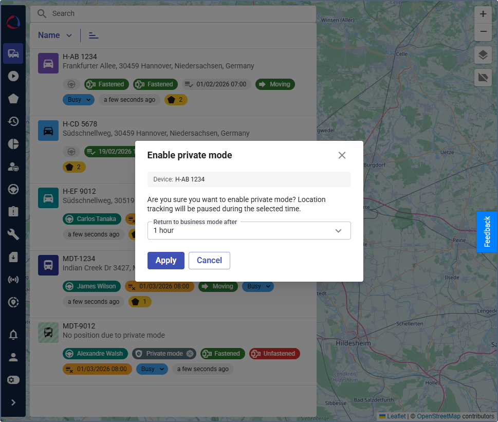

To enable private use for a device using the Manage private use widget in Wialon Platform FleetSpace, follow these steps:
  1. Log in to Wialon Platform FleetSpace.
  2. Navigate to the Devices page or Drivers online page, depending on where the Manage private use widget is configured.
  3. Select the device for which you want to disable private use. In the case of drivers, you disable private use for the device to which the driver is assigned.

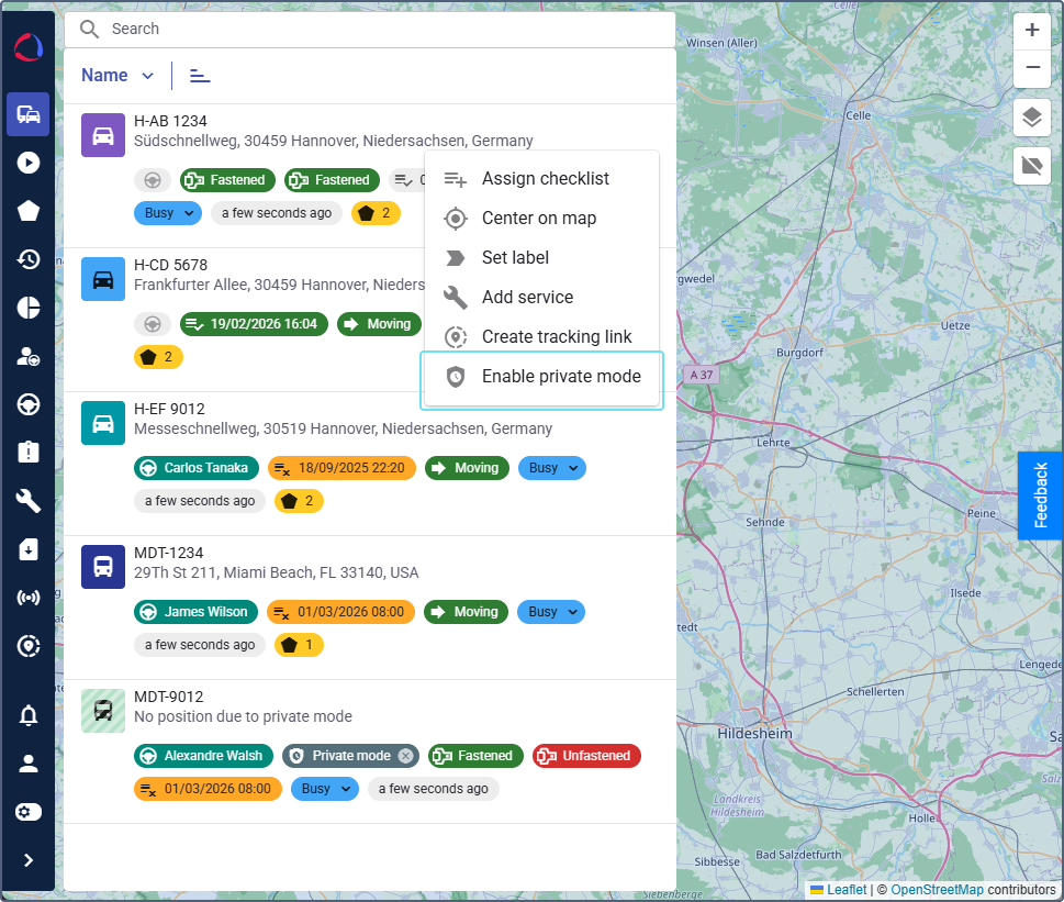

  4. Locate the Manage private use widget indicated with the icon icon of a shield with a clock inside on the list row. It can be located directly on the row or inside menu that opens after clicking on the three dots icon three dots icon. If not, click on the item to open the details page and locate the widget there.
  5. Click on the Manage private use widget icon of a shield with a clock inside.
  6. Set a duration for the private mode. You can set a preconfigured value or set a custom duration in the calendar for up to 30 days.
  7. Click Apply.
