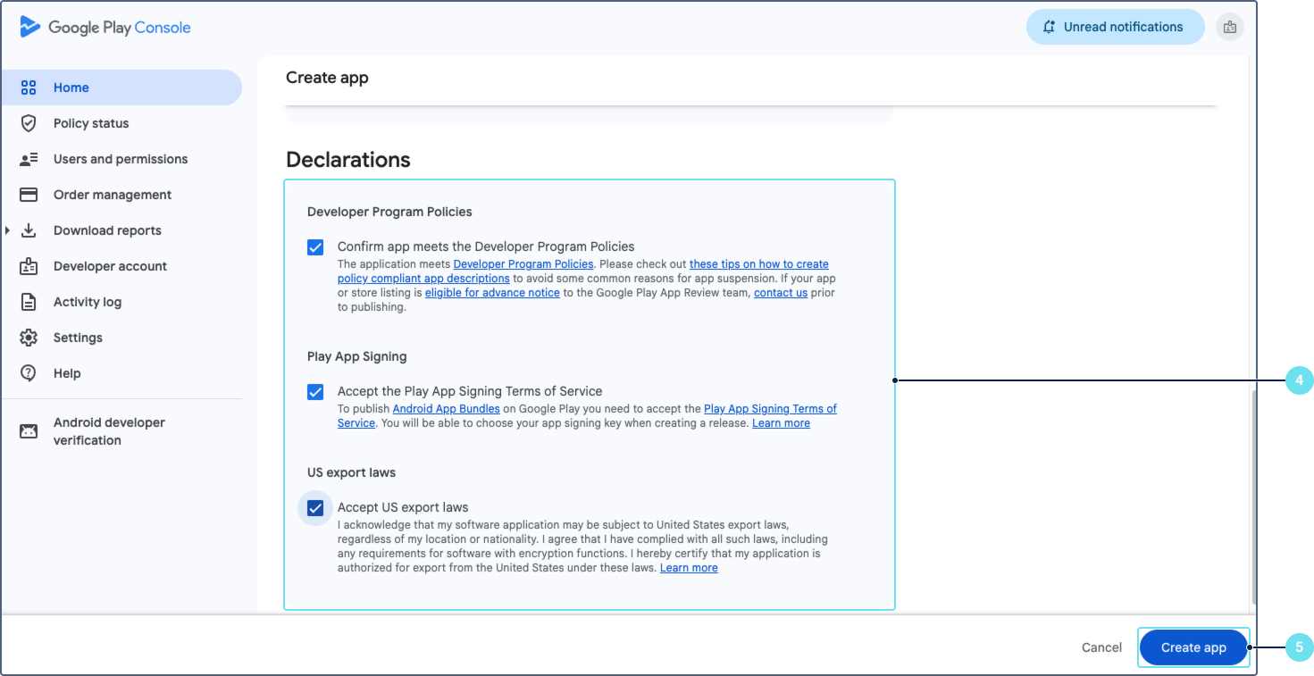

  4. In the Declarations section, accept the three required declarations:
    • Developer Program Policies: Confirm that the app meets the Developer Program Policies.
    • Play App Signing: Accept the Play App Signing Terms of Service.
    • US export laws: Accept the US export laws.
  5. Click Create app.

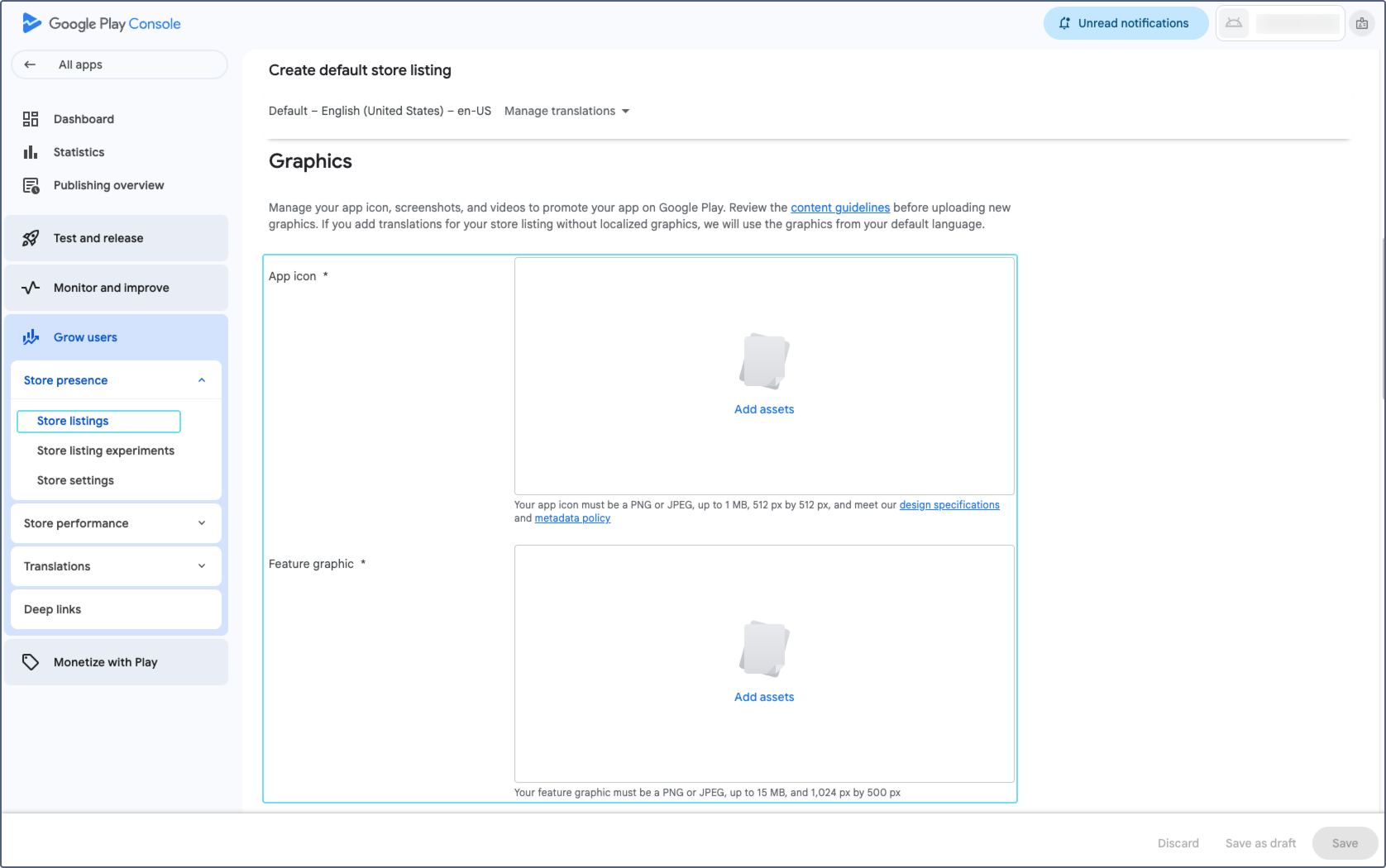

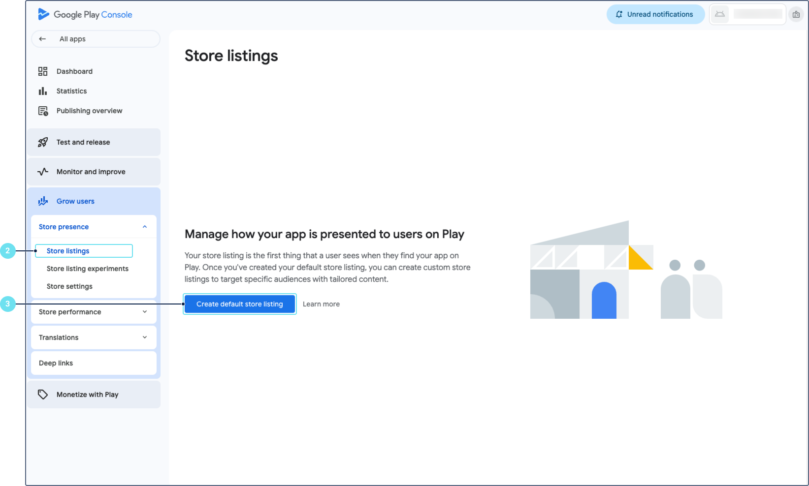

  2. Navigate to Grow users > Store presence > Store listings.

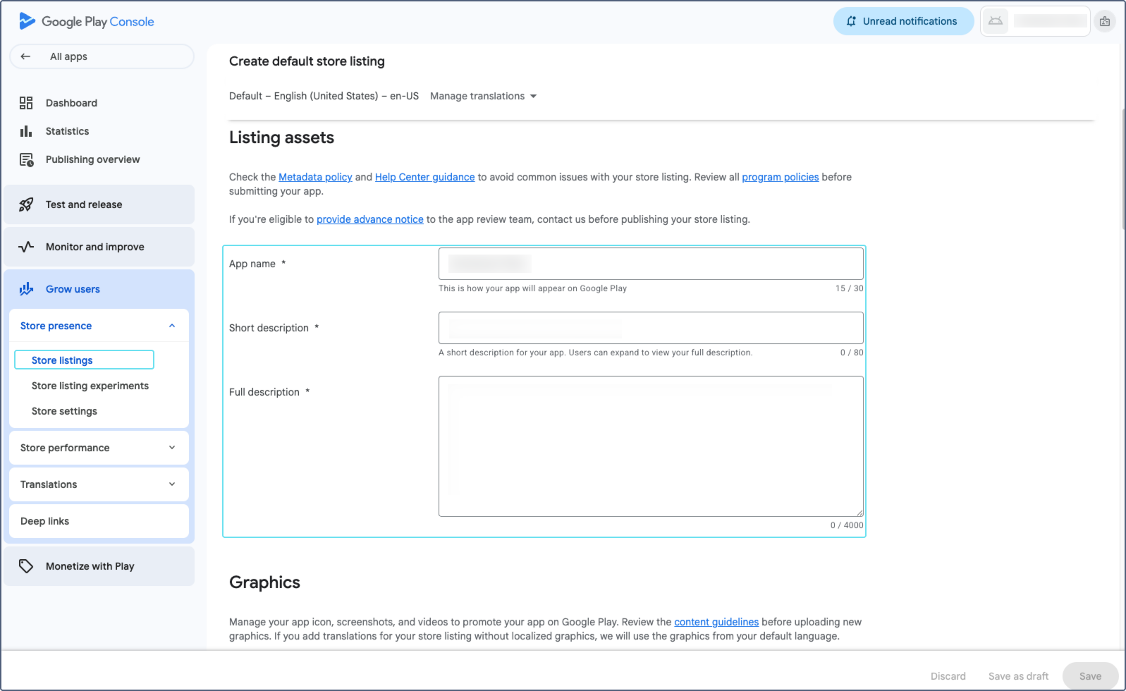

  3. Click Create default store listing.

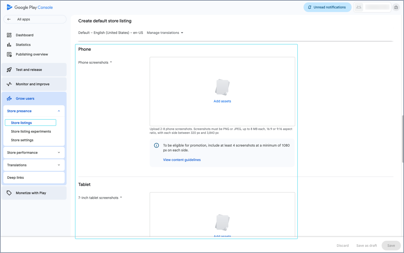

  4. Fill in the required fields:
    • App name: The app name as it appears on Google Play.
    • Short description: A brief description of the app (up to 80 characters).
    • Full description: A detailed description of the app (up to 4,000 characters). It must differ from the short description.
    • App icon: The app icon. Requirements: PNG or JPG, up to 1 MB, 512×512 px.
    • Feature graphic: A banner image displayed at the top of the store listing. Requirements: PNG or JPG, 1024×500 px, up to 15 MB.
    • Screenshots: At least 2 screenshots for each supported device type (phone, tablet). Recommended: upload screenshots showing the login screen, form screens, and key features. The screenshots must be in the same language as the default language specified in Step 1. If your app supports multiple languages, add screenshots for each language in the corresponding store listing translation.
  5. Click Save.

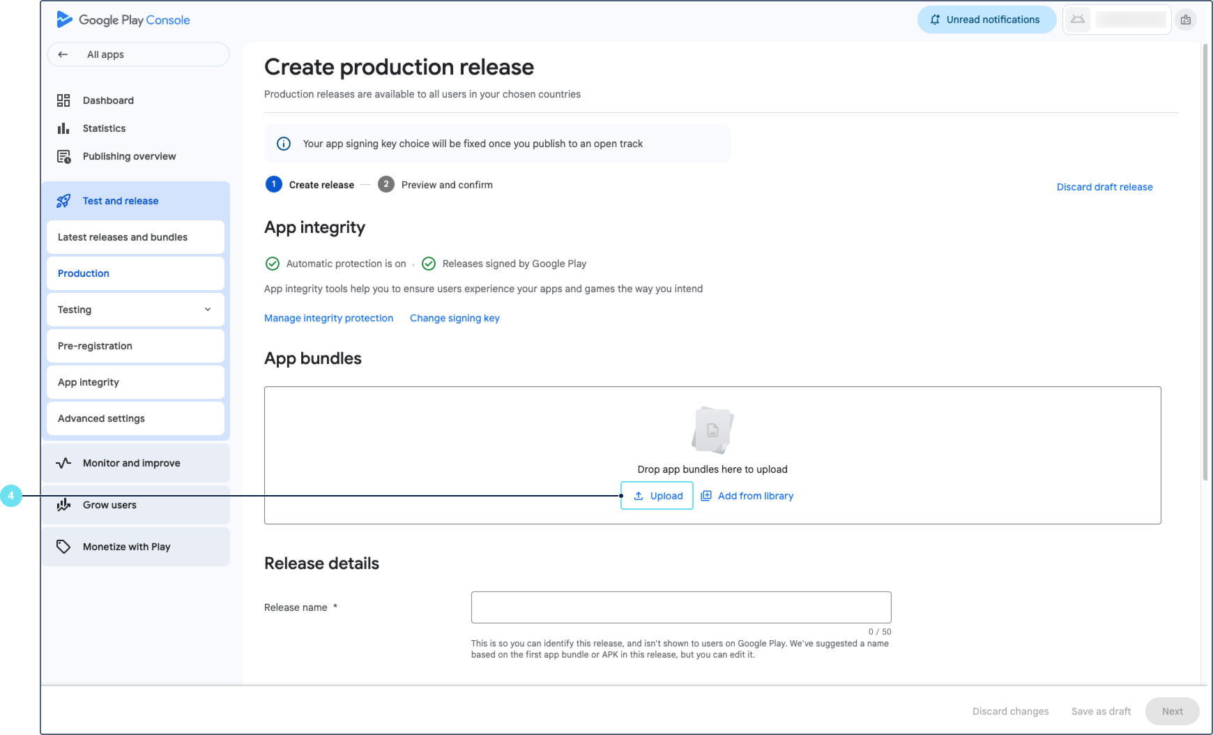

  1. In Google Play Console, open your app.
  2. Navigate to Test and release > Production.
  3. Click Create new release.
  4. In the App bundles section, click Upload and select the AAB file downloaded from Wialon Platform Studio.
  5. (Optional) In the Release notes section, add release notes. Release notes are not required for the first release.
  6. Click Save to save the release as a draft.

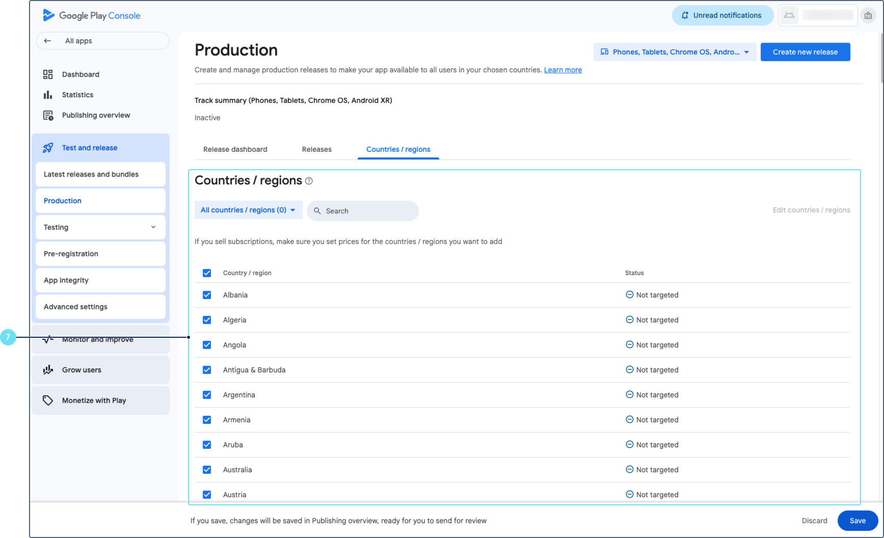

  7. Select the countries or regions where you want to distribute the app.
  8. Review the release details. Fix any issues marked in red. You can skip items marked with yellow warnings.
  9. Click Send for review.

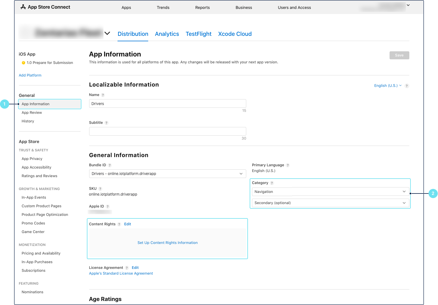

Step 2: Set up the app information
  1. In App Store Connect, open your app and navigate to General > App information in the left sidebar.
  2. Fill in the required fields:
    • Category: Select the category (for example, Navigation).

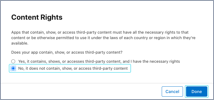

    • Content rights: Select No. Click Done.

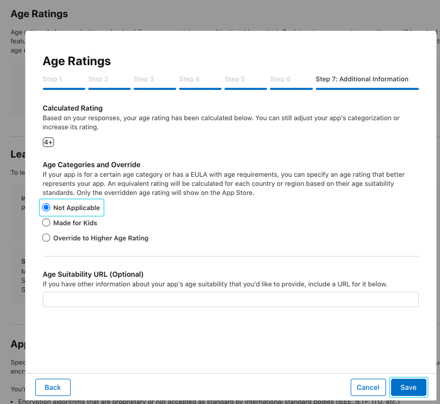

  • Age ratings: Click Set Up Age Rating, select No for all content descriptions. In the final step, select Not applicable for the app environment. Click Save.
  1. Click Save.

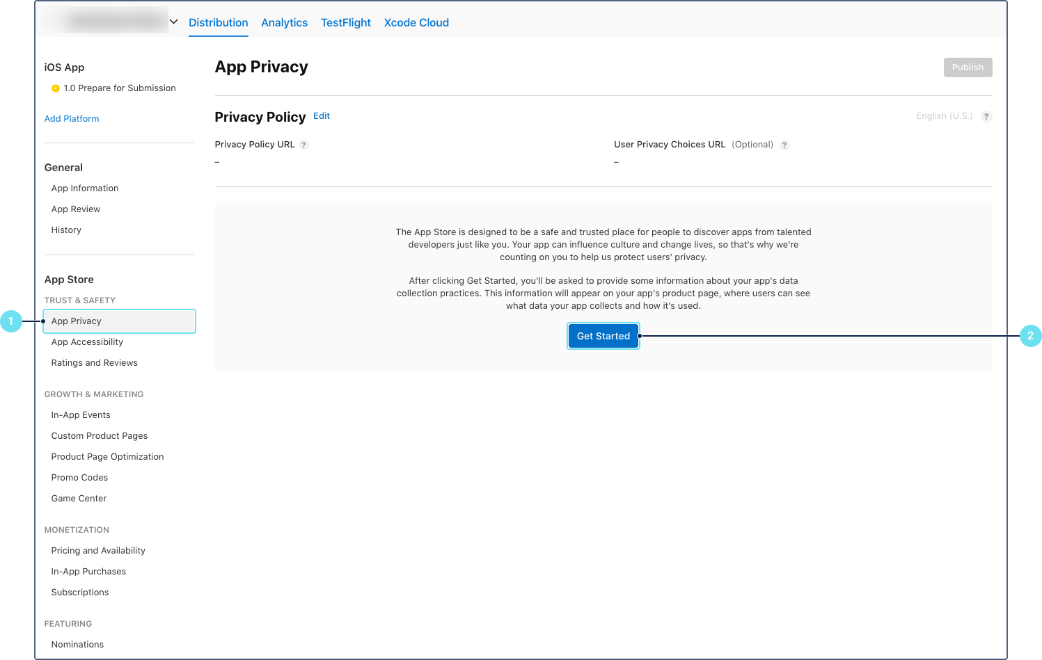

Configuring app privacy (data collection)
  1. In the left sidebar, click App Privacy.
  2. Click Get Started.

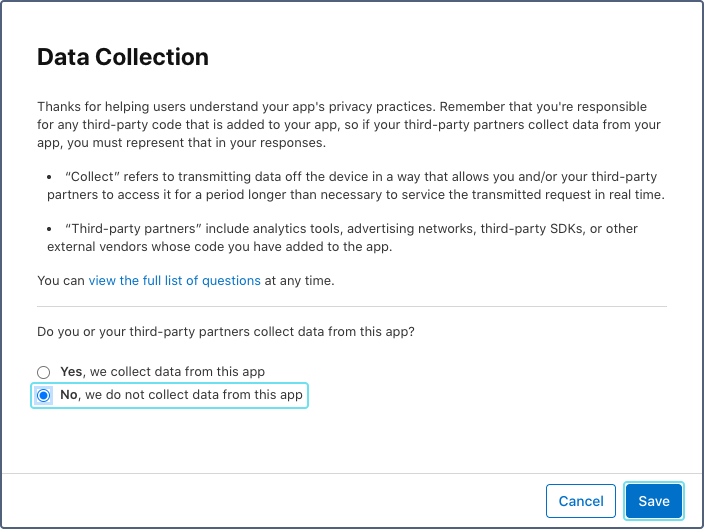

  3. Select whether the app collects data. The white-labeled Wialon Driver app doesn’t collect data beyond what is necessary for its functionality.
  4. Click Publish.

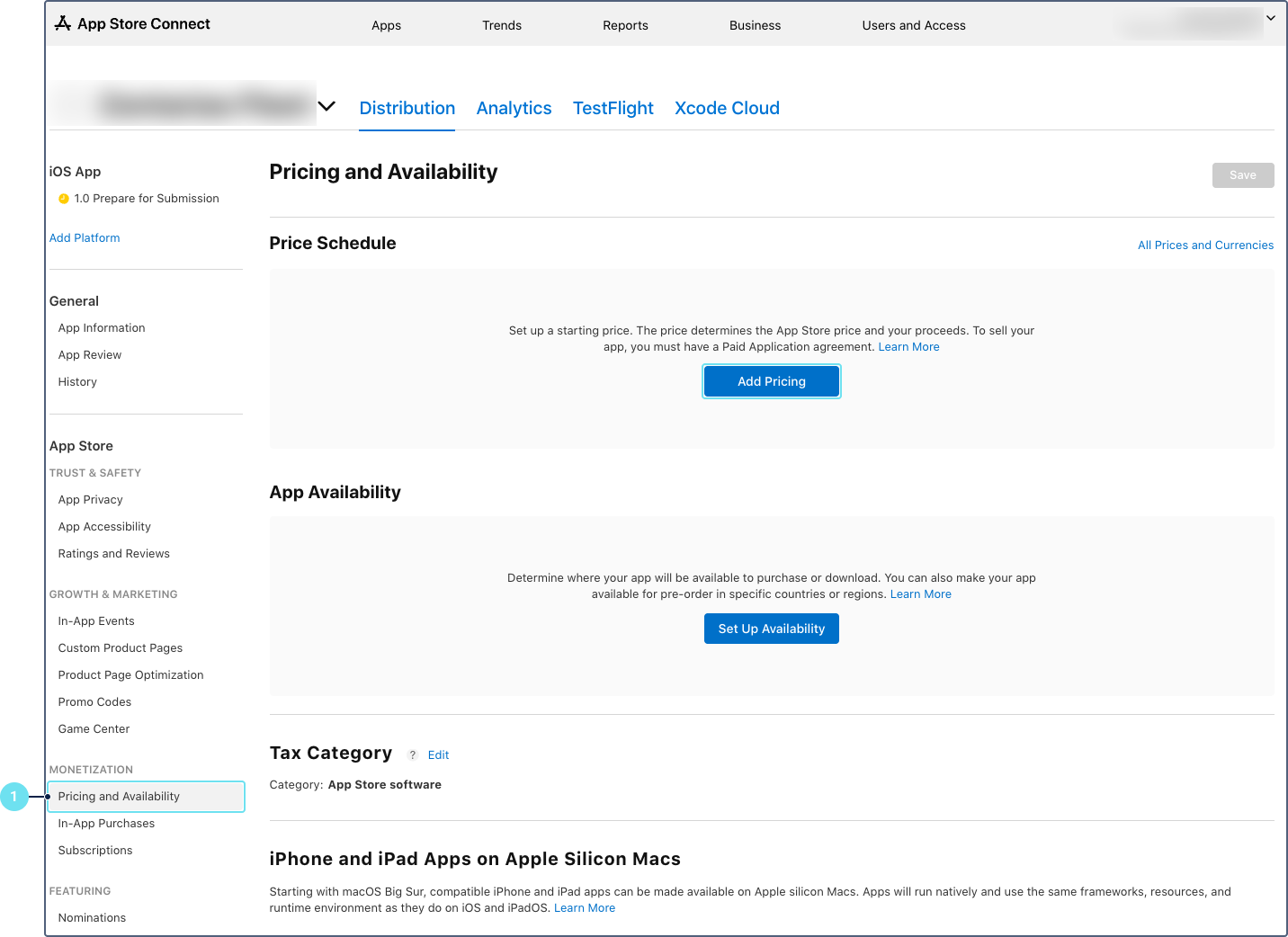

Step 3: Configure pricing and availability
  1. In the left sidebar, navigate to Monetization > Pricing and Availability.

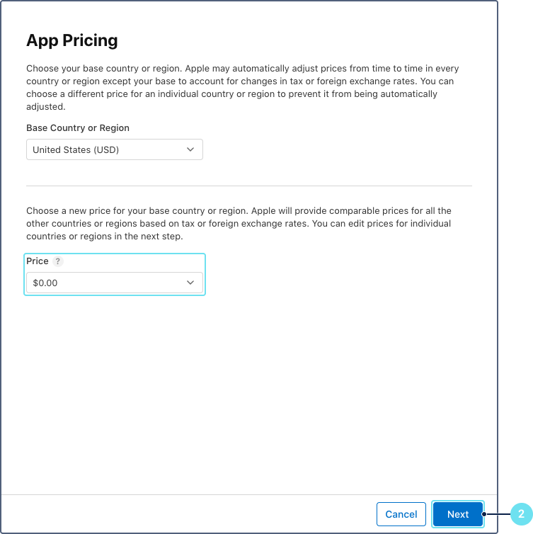

  2. In the Price Schedule section, set the base price to 0 (free). Click Next.
  3. Review the pricing summary and click Next.
  4. Click Confirm to save the price schedule.

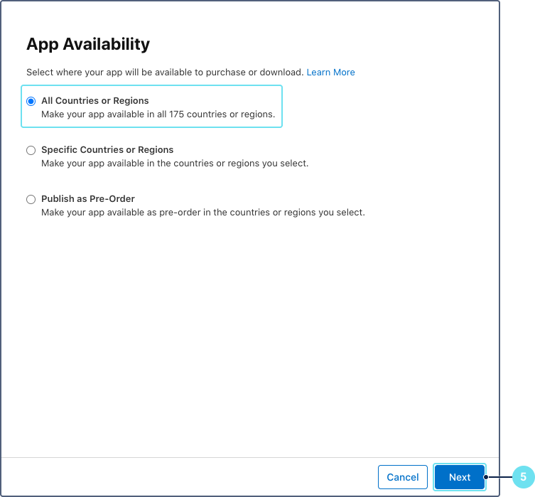

  5. In the Availability section, select All countries and regions to make the app available worldwide. Alternatively, select specific countries or regions based on your business needs. Click Next.
  6. Click Confirm.
  7. Click Save.

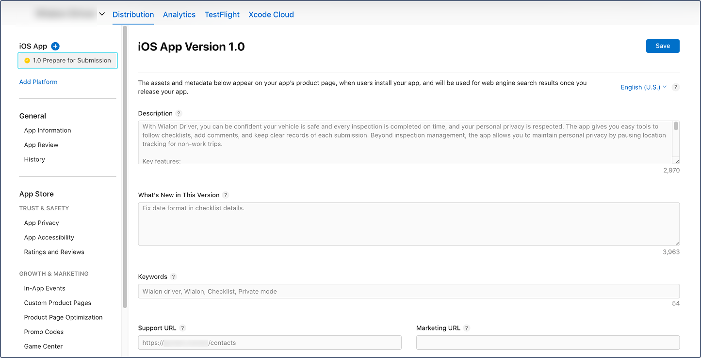

  1. In the left sidebar, navigate to the iOS version page (for example, 1.0 Prepare for Submission).
  2. In the App Screenshots section, upload at least 3 screenshots for each required device size (for example, iPhone 6.5"). Upload screenshots that show the main features of the app (for example, the login screen, form list, form completion screen, driving score screen, and the private mode screen). The screenshots must be in the same language as the primary language specified in Step 1. If your app supports multiple languages, add screenshots for each language in the corresponding App Store localization.
  3. Fill in the following fields:
    • Description: Enter a detailed description of the app (up to 4,000 characters). Describe the key features: forms, private mode, driver behaviour assessment, and so on.
    • Keywords: Enter search keywords separated by commas (up to 100 characters total). For example: driver, form, private mode, driving score, driving violations.
    • Support URL: Enter the URL of your customer support page.
    • Version: The version number is set automatically based on the uploaded build (for example, 1.0). Verify that it matches the build version.
    • Copyright: Enter the copyright holder’s name preceded by the year (for example, 2026 Your Company Name).
  4. Click Save.

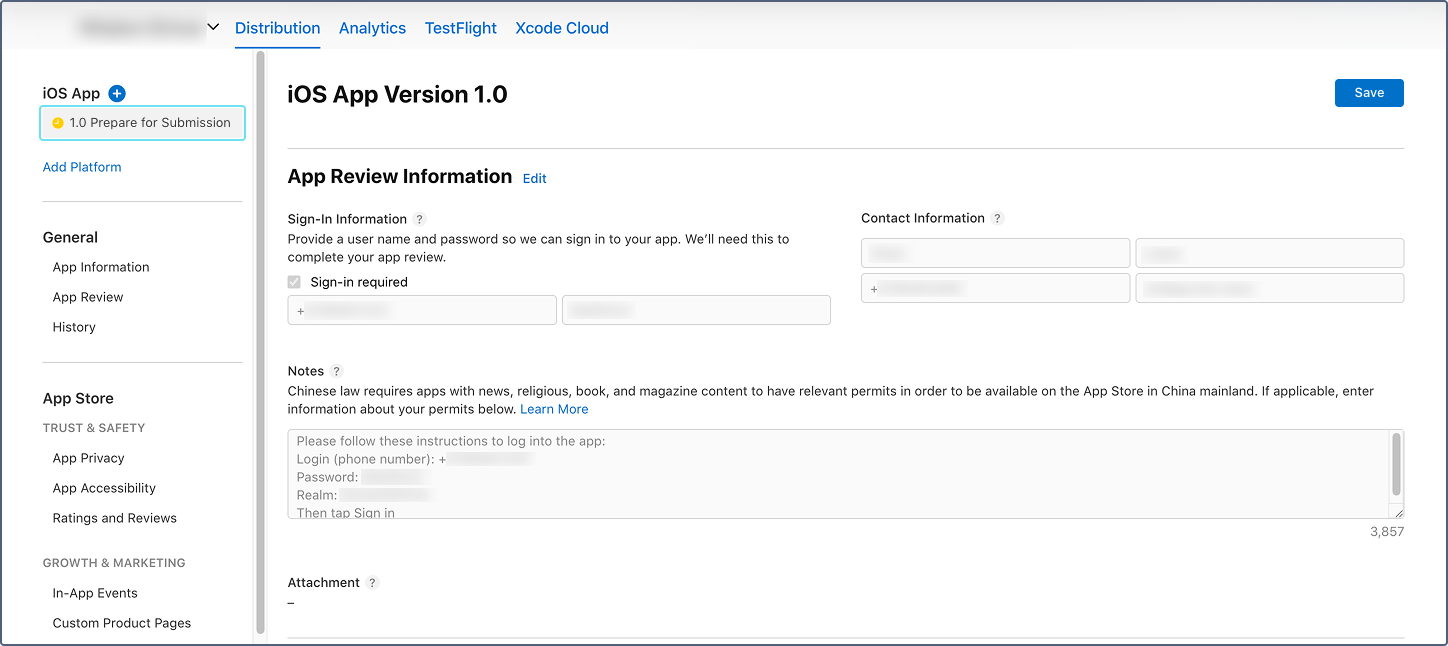

Step 5: Fill in the app review information
Apple requires a demo account and contact details so that the review team can test the app during the review process.
  1. On the version page, scroll down to the App Review Information section.
  2. In the Sign-in information subsection, provide demo credentials for a test driver account:
    • Sign-in required: Enable this option.
    • Username: Enter the phone number of the demo driver account.
    • Password: Enter the password of the demo driver account.
    Create a dedicated demo driver account in Wialon Platform FleetSpace before submitting. The account must be active and functional during the entire review period. Make sure the demo driver is assigned to a device and has at least one form assigned.
  3. In the Notes field, provide any additional instructions for the reviewer. For example, specify the realm ID required for login or basic steps for using application features.
  4. In the Contact Information subsection, provide the details of the person Apple can contact if there are questions during the review:
    • First name: The contact person’s first name.
    • Last name: The contact person’s last name.
    • Phone number: A phone number for Apple to reach the contact person.
    • Email: An email address for review-related communications.
  5. Click Save.

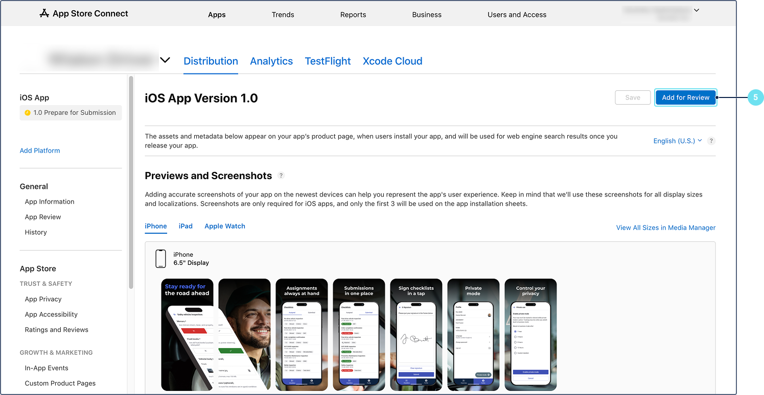

  5. Click Add for Review.
  6. Click Submit to App Review.
